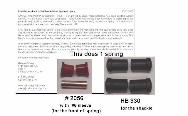

    While I'm awaiting the arrival of my body panels I want to rebush the suspension. Whats the general concensus...Poly or Rubber? And where's/who's the best supplier? Is it just simply measure the openings and order?

    Thanks Donivan65...is there a supplier name? What do you recommend...poly or rubber?

    I recommend getting something that fits,,,,,,this is what I found,,,,,,National Spring has the poly bushings and sleeve that will replace the metal cartridges for the front end of the springs,,,,,they might have the shackle end HB 930 bushings,,,,,however,,,,,those packs of 4 from the other place is a way better deal,,,,,,once in a while we find a spring that has a larger bushing on the front end of right front spring.......
    Suspension bushings Nation10
    Suspension bushings Bushed10

    Thank you....inexpensive too! Probably the best thing to do is remove them...measure...then order.

    I see Don mentioned the different size bushing sometimes in the front passenger side front bushing. This happened to me and so I needed to order a different bushing. National had everything I needed and easy to deal with. I suggest finding out before ordering if you need the large as they charge a bit excessive for shipping.
    I also suggest replacing the bolts. They were like $10 total and was so much nicer when putting it back together. That old rubber was actually caked to the bolt which was a pain to try cleaning off and putting into the new bushings. $10 is cheap to save sanity, and when spending $100 on bushings, what is $10 on new grade 8 bolts.
    Don's pressing tool is very nice. I didnt have that set up so I used an air chisel and they came right out.
