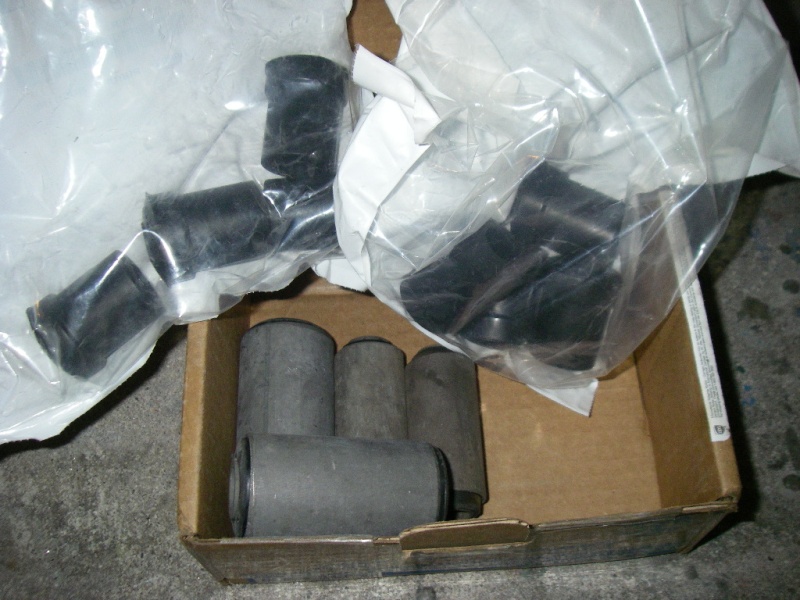

    After a few emails and calls, Tom, at McVeigh Truck Springs in Michigan I got my order:
    SUSPENSION BUSHINGS for my Econo Pickup Imgp7111
    Tom's prices have been reasonable and shipping was minimal. I think I paid under 38 bucks for all
    the front including the chassis bushings, and about the same for the rears. Shipping was like 7 bucks.
    SUSPENSION BUSHINGS for my Econo Pickup Imgp7112

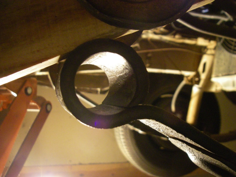

    SUSPENSION BUSHINGS for my Econo Pickup Imgp7115
    Poser shot. Literally metal-on-metal, could hardly wait to see the difference with the new rubber.

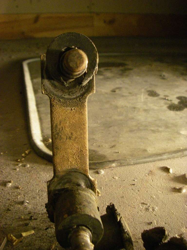

    The shackle end was likewise easy. Heads up on the side with the Fuel Filler
    Pipe. It will take a little bit of "origami hands" to fit the nut and wrench in
    there, ha.
