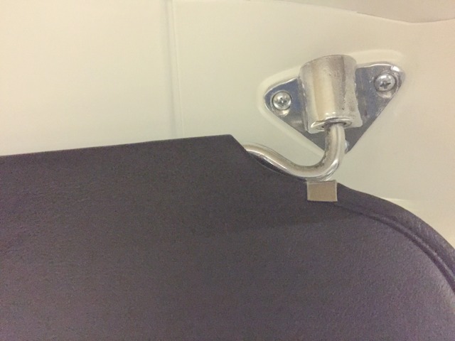

    I was excited to get a set of repop visors, so I figured I’d take a couple of minutes and see how they look.  Ever try to insert the support rod into a new set of visors?  I’ve pressed on axle bearings that take less effort.  After about an hour I got one of them done!

    [quote="66e100pu"]I was excited to get a set of repop visors, so I figured I’d take a couple of minutes and see how they look.  Ever try to insert the support rod into a new set of visors?  I’ve pressed on axle bearings that take less effort.  After about an hour I got one of them done!
    A-100 Project - Page 2 Img_0011[/quot
    What's the trick with the install? I am ready to order a set.

    OutofSight wrote:
    66e100pu wrote:I was excited to get a set of repop visors, so I figured I’d take a couple of minutes and see how they look.  Ever try to insert the support rod into a new set of visors?  I’ve pressed on axle bearings that take less effort.  After about an hour I got one of them done!
    One side was a bear, the other side was easier.  What I did was find the right sized Phillips screwdriver and used it to open the channel up the best I could by twisting and pushing.  Next I inserted the rod about 1-2" in the visor (forced it as far as I could get it).  Then I positioned the swivel end so the edge of it could be placed on the carpet; held the visor vertically straight and pounded the rod fully home by striking the pivot end against the floor.  It sounds brutal, but it goes in at about an inch at time.  The trick is hit it straight and square and use both hands to support each edge of the visor (it's like a slide hammer in reverse).  There is one shot to get it right because trying to get it out again once you've started driving it in would be a nightmare.  On the other side of the visor, I found somebody on ebay that makes the tips for a Mopar B body out of Derlin.  These are bulletproof, unlike the plastic tubes that came stock.  I used the Phillips to open up the other side and beveled the ends of the tips slightly on a grinding wheel.  Once started in the channel, these pound in the same way but with far less effort.  I had no center supports for the tips, so I used 94-01 Dodge Ram pickup units.  I had to hit the backs on a grinding wheel to level out some protrusions that they have, but the curvature works perfectly with 2 minutes of work.

    Do you have any pics of the other end, and info on the tips?

    OutofSight wrote:Do you have any pics of the other end, and info on the tips?
    I'll get some pics over the weekend.  In the mean time, these are the tip supports:
    http://www.ebay.com/itm/171983220237?_trksid=p2060353.m2749.l2649&ssPageName=STRK%3AMEBIDX%3AIT
    These are also much stronger than the originals.
    These are the tips:
    http://www.ebay.com/itm/291407321734?_trksid=p2060353.m2749.l2649&ssPageName=STRK%3AMEBIDX%3AIT

    Post by 66e100pu Wed Nov 25, 2015 9:10 pm
    I managed to snap a quick cell phone photo - not the best, but it shows the other end ok.
    A-100 Project - Page 2 Img_0013

    Thank you very much for th pic, it helps a lot!

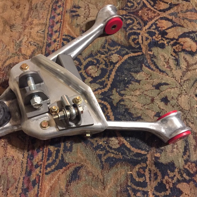

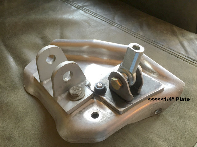

    I find it amazing that the simplest job on a typical build almost always turns into a major project somehow!  I was tackling the front sway bar when I realized that the lower control arm shock mounting plates are made from aluminum too.  Not going to have any luck welding the steel mounting tabs to aluminum, so I had to fab some steel plates to act as a mounting base.  My mig is not up to the task of handling 1/4 “ and 3/8” steel, so I’ve got it all set-up for the welder – now we’ll see how long it sits in the shop.  I’m sure I can find some other ‘simple’ things to do while I’m waiting….

    Got my stuff back from the welder in no time, so I mocked up the sway bar to make sure everything works without contacting the coilovers, subframe, etc.  I always think that I’m setting up modern suspension in a 50 year old truck, until I remember that the suspension is 30 years old too.  That requires that everything be disassembled, cleaned, and new bushings everywhere.  There are no factory bushings available for the 84-87 Corvette, so Prothane is the only option left.  They can be pretty stiff and squeak in the cold, but it is what it is.   Waiting for the new ball joints and tie rod ends to finish it all up.  When the truck was primed after media blasting, the overspray hit the front-end pretty good.  The clean-up is a major PITA, but the aluminum components really are a work of art.  I have to resist the urge to polish everything.  The truck is being built as a driver, not some trailer queen that you have to clean with Q-Tips.  With everything removed, I’ll prep the underside and shoot it in chassis black so when it all goes back in it’s done.  Also mounted the dual spun aluminum fuel tanks – they sit tucked up between the chassis rail and sheet metal ahead of the rear wheel on each side.  I used flip top fillers that are mounted to the bed floor.  There is really no room for a rear mounted tank with the IRS taking up as much room as it does.  I’ll get some pictures of the tank installation eventually.

    I finally got my visors installed, man what a chore, but I'm glad it's done!
    Thanks for your help!
