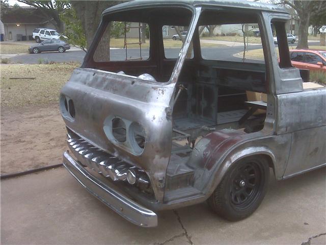

OK, BEEN WORKING MORE IN THE GARAGE. ALMOST FINISHED WITH THE FRONT GRILLE AND BUMPER FABRICATING. I ENDED UP CUTTING OUT 3 INCHES FROM THE CENTER OF THE ORIGINAL FRONT BUMPER AND WELDED IT BACK TOGETHER WITH A SLIGHT VEE TOWARDS THE REAR TO HELP IT BLEND WITH THE CURVE OF THE GRILLE. I STILL DONT KNOW ABOUT THE POSITION OF IT YET, STILL MOVING IT AROUND AND LOOKING AT PICS. I ALSO WENT CRAZY ON THE STEERING SHAFT RELOCATION AND ENDED UP BUILDING A CHAIN AND SPROCKET SET UP TO POSITION THE SHAFT 8 INCHES FORWARD. IT ACTUALLY TURNED OUT PRETTY COOL AND I OVERDESIGNED IT TO BE VERY STRONG. I SAW A TYPE OF SET UP LIKE THIS IN A ROD MAG, AND IT LOOKS COOLER THAN UNIVERSAL JOINTS. ANYWAY HERE'S SOME PICS.

looks good, the bumper just looks to stock for allthe work your doing. What about some bumperettes.....love the grill

I'M GLAD YOU SAID IT! I THINK THAT'S WHAT I NEEDED TO HEAR. I AGREE IT JUST DOES'NT FIT QUITE RIGHT. FOUND A 52' MERC BUMPER ON FLEABAY, I MAY TRY SOMETHING WITH IT. THANKS AGAIN FOR THE INPUT! YOU GUYS ARE AWSOME!texasjohn wrote:looks good, the bumper just looks to stock for allthe work your doing. What about some bumperettes.....love the grill

GOT THE MERC BUMPER FITTED, AND IT LOOKS GREAT. BUILT A SPLASH PAN AND ALMOST DONE WITH FINAL FINISH FITTING AND WELDING MOUNTS. WILL POST MORE PICS OF IT SOON.

Looks like it was made for it, very cool!!!!

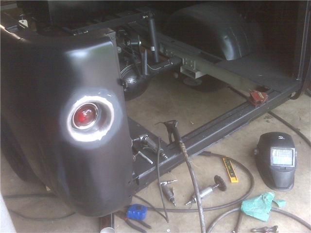

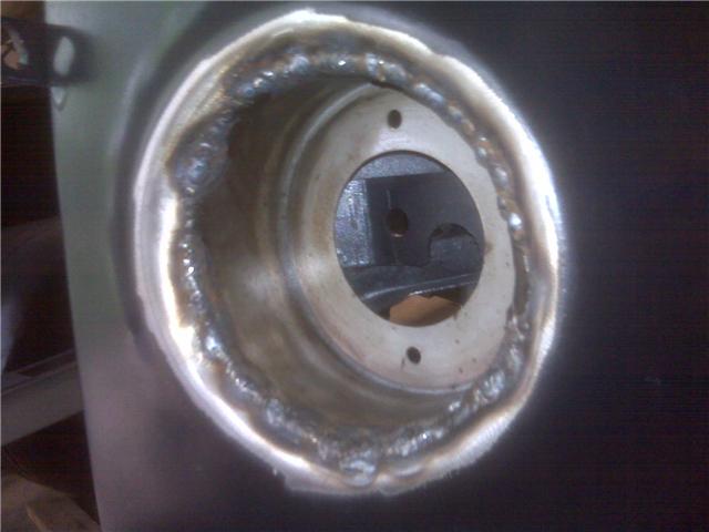

WOW, I FINALLY GOT HER PRIMERED!! IT'S BEEN A LONG TIME COMING BUT I FINALLY PUT THE EPOXY PRIMER ON LAST WEEKEND AND IT LOOKS GREAT. ALSO BOUGHT SOME 1950 PONTIAC REPRO TAIL LIGHTS AND FRENCHING BUCKETS AND INSTALLED THEM YESTERDAY. IT'S GETTING CLOSER!!!

You make all this custom bodywork look easy, primer looks great and the tailights are over the top!!!

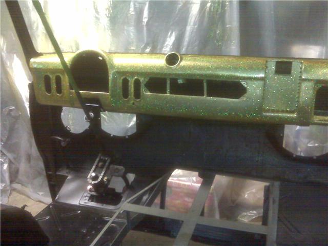

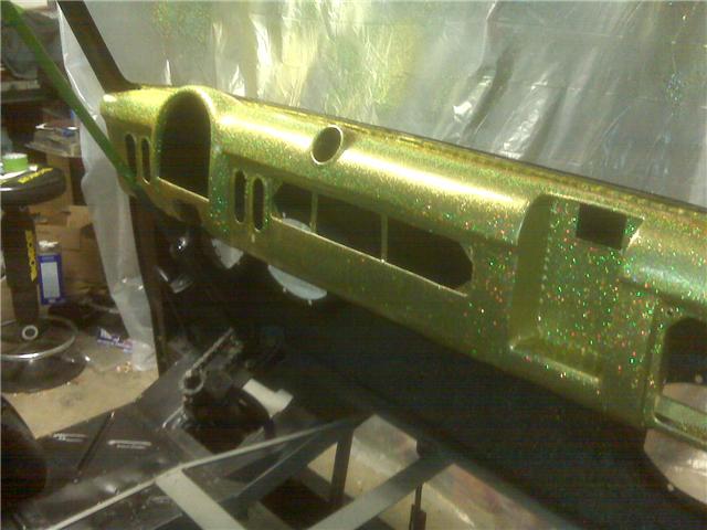

I STAYED UP LATE AND GOT FLAKED!!! NOW I'M SITTING IN MY TRUCK MESMERIZED BY ALL THE PRETTY COLORS!! WOW! I DID'NT THINK IT WOULD LOOK THIS COOL! NEXT I'M GONNA DO THE ROOF AND SOME SCALLOPS TOO! ZOOM IN ON THESE BUT BE WARNED, YOU BETTER PUT ON YOUR SUN GLASSES!![img][/img][img][/img][img][/img][img][/img][img][/img][img][/img][img][/img]

Very cool to see some color going on

Your '50 dash insert is gonna stand out great in there.Gonna have to drive with ya shades on.Way cool.
