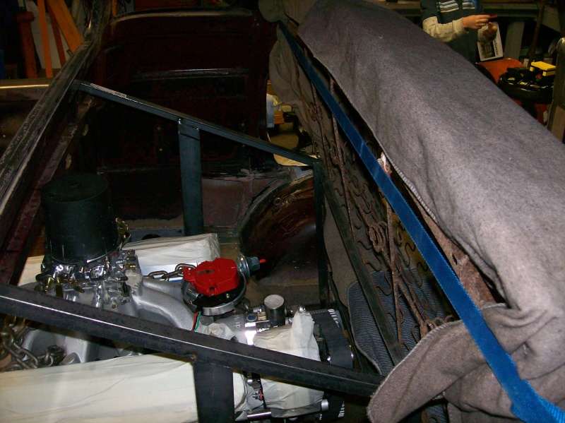

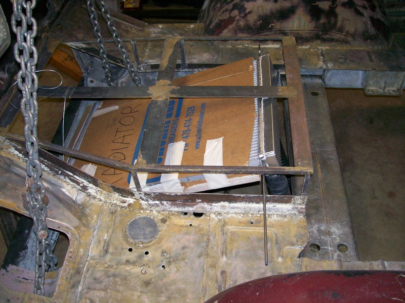

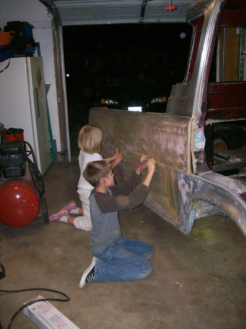

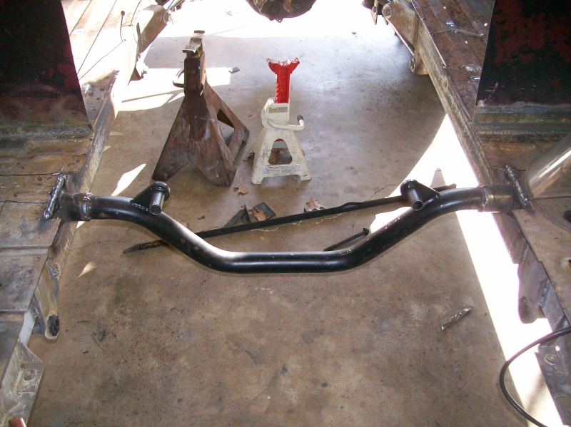

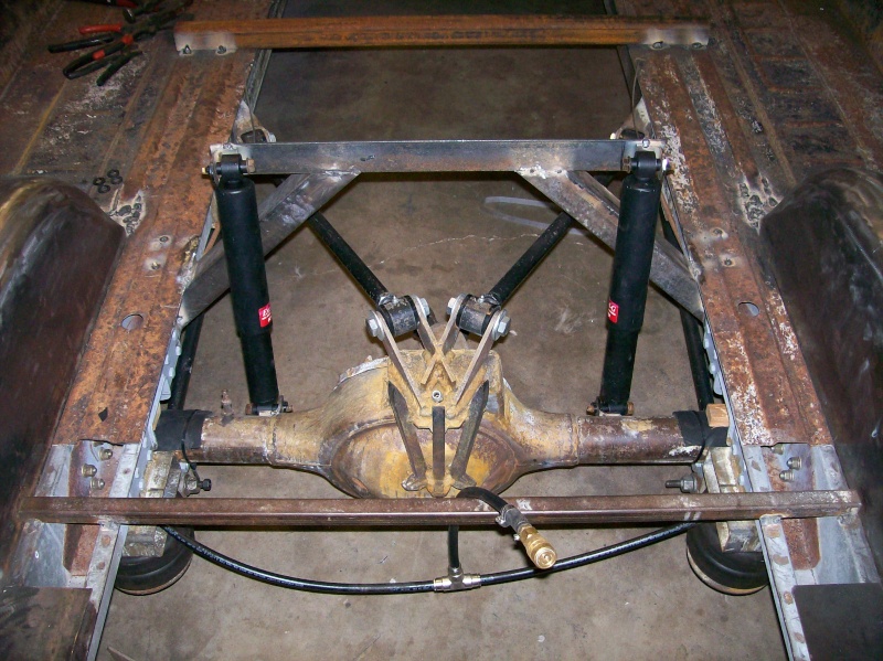

BEEN WORKING HARD LATELY SINCE I GOT MY TAX RETURN. HERE'S SOME PICS TO GET YOU GUYS UP TO DATE.THIS IS THE CULMINATION OF MANY LATE NIGHTS OF WORK.[img][/img] RUST CONVERTER FOR THIS.[img][/img] STUFF WORKS GOOD![img][/img] CUT OUT FRONT INNER FENDERS AND RAISED THEM UP. I NEVER WANT TO WELD UPSIDE DOWN AGAIG!! OUCH![img][/img] EVEN GOT THE KIDS TO HELP WITH THE DIRTY WORK![img][/img][img][/img] SPRAYED ALL METAL INSIDE AND OUT WITH METAL BLAST, (PHOSPHORIC ACID) AND RINSED AND DRIED.[img][/img] YEAH! I REALLY LIKE COFFEE![img][/img] FENDERS BIGGER![img][/img][img][/img] BUILDING THE REAR CROSSMEMBER/SHOCK MOUNT[img][/img][img][/img]THE RADIATOR FITS! AWSOME![img][/img] TIME FOR SOME HORSES![img][/img] GONNA BE A SHORT DRIVE SHAFT! DONT KNOW IF I'LL HAVE TO INSTALL THE TRANS SHORTY COVER OR NOT.[img][/img] THIS ENGINE MOUNT ONLY NEEDED SLIGHT MODS.[img][/img] MADE A TRANS MOUNT OUT OF AN OLD BIKE RACK.[img][/img] I HATE TO HAVE TO COVER UP THAT PRETTY ENGINE![img][/img][img][/img][img][/img] THE SEAT STILL FITS! YAAAH![img][/img] MY SON CODY, BUILT HIS FIRST ECONOLINE TODAY!

My tubbs are made like yours, have to say his you work FAST, getting alot done in a short time. Might be something about that coffee

I think some plexiglass for the engine cover is needed to show that beauty off!

VERY NICE! LOVE the brake set up. Wish we could see more and hear more on that.
