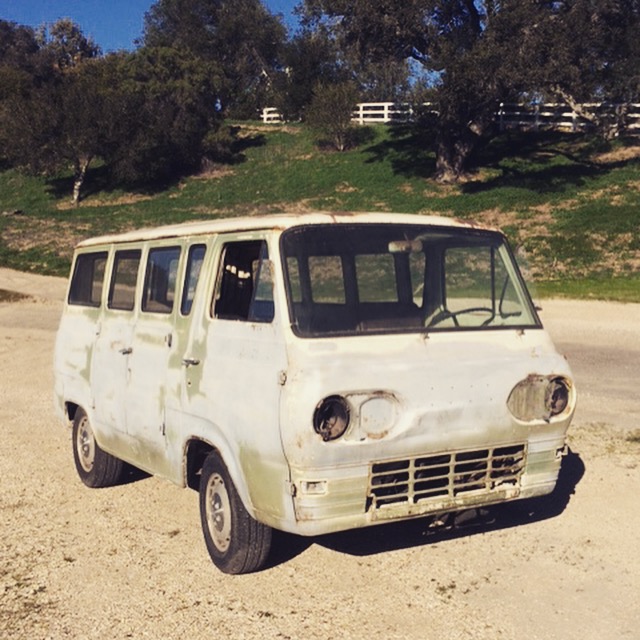

    Hi all, been checking out the site for over a year and am glad to finally be throwing my project into the mix.  After looking for awhile with not much luck I ended up posting a want ad on Craigslist.  Found this beauty about an hour away at a great price.  Some small rust thru areas but overall pretty solid.  When I brought it home it sat for the last year while I finished up a hot rod project.  During that time I've been reading a lot on this site as well as purchasing parts.  Plans are for nice driver to take the family out in.  I love them slammed to the ground but looks like more work than I've got time for right now.  This will hopefully be the start of a build thread.  I'm really looking forward getting this back out on the road.

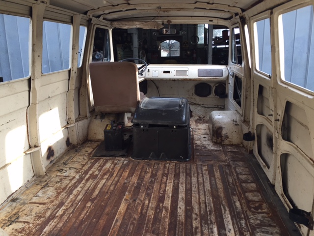

    My new '63 Falcon Image10

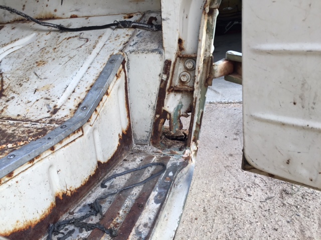

    Went ahead and stripped the interior and gave it a wash inside and out.  Removed the glass and some of the hardware.  There are just a few main areas that need rust repair, the bulk that you see is just surface rust.  On both sides below the turn signals there is rot as well as inside the cab in the lower door area.  There are also a couple places on the rear drip rail that I'll have to address.  I'm taking the next week off specifically so I can try and make some progress on the body work

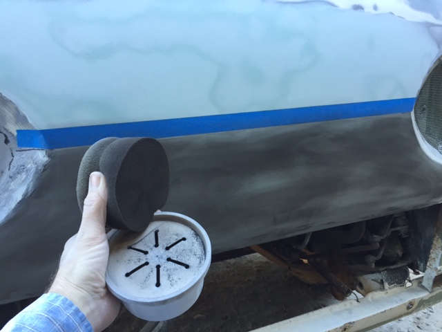

    Post by Hip E van Mon Feb 29, 2016 11:51 am
    My new '63 Falcon Image15
    Here's what I use when I'm getting close on a body panel.  This is guide coat made from powdered grafite that I got off eBay.  Rub the sponge over the whole area and then block sand it down.  Everything that stays the dark color is a low spot.  The tape lets me know where the center of the peak is.  I sand up to the tape, remove it and put a new strip down low and then sand down to it from the top.  You can see I'm a little low near the headlights and a couple other places
    My new '63 Falcon Image16
    I also use some wax remover in a shur-shot and spray the panel then look at it from the side to see what the reflected light is showing me.  That will catch things you might have missed with the guide coat.   You pretty much keep fixing problem areas over and over till it's right.  In my case I'm just shooting for good enough, this isn't going to be for show, just a nice little driver.

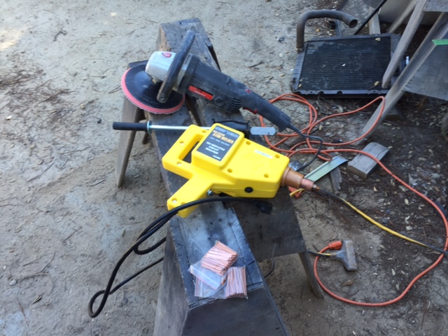

    A couple tools I picked up for this project that I really like.  The variable speed sander is working out well for paint removal but I also like it on the slowest speed for roughing in the body filler.  My arms are already screaming at the end on the day so I need to give myself a break where possible.  The other Harbor Freight purchase was their pin welder.  It's awesome for those places you can't get a hammer on the back side.  It comes with the slide hammer and a bunch of pins.  Wish I bought this years ago.

    Started patching in the rusty panels.

    Sandblasted the rain gutters.  They are in pretty good shape till you get to the back.  It looks like a tricky shape to try and replicate.  What are most people doing for fixing this?

    Donor parts from another van. It is where three pieces of metal come together

    Thanks Bruce. I don't have ready access to a donor cab right now, have to see if I can hack something together. I noticed lots of rust when trying to peek in from inside the cab over that lip towards the drip rails. Was thinking about putting some of that rust converter into a spray bottle and just working my way around the whole inner roof to try and stop future problems. Seems better than nothing but would be curious to hear if you all are doing some thing different.

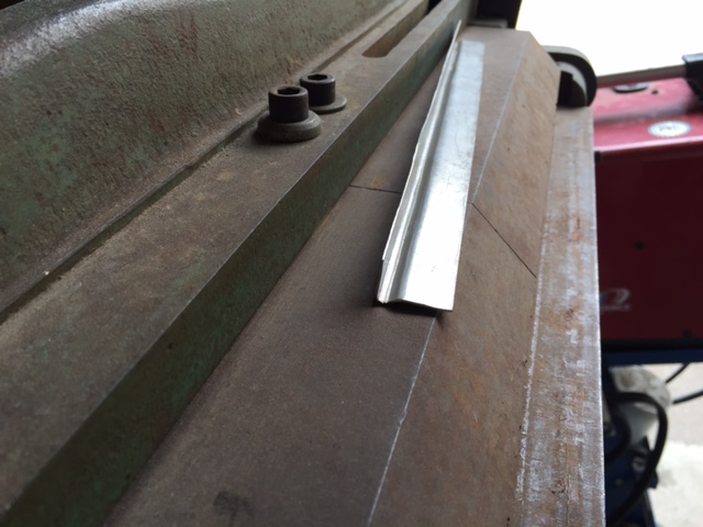

    Trying to figure something out on those drip rails today.  Using a bead roller to put a flange down.

    Put it in the brake and bent it.  The little channel is kind of like the one on the factory gutter.  I think with a bit more practice I can tighten that angle up

    Ran it thru the shrinker to get the right bend
