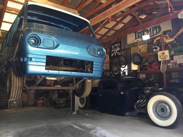

    Post by Hip E van Sun Dec 31, 2017 11:15 am
    Extra pics
    My new '63 Falcon - Page 4 Img_4326
    Experimenting with different ride heights in the back, think I want to raise it about 3 inches.  Anybody got some good insight?

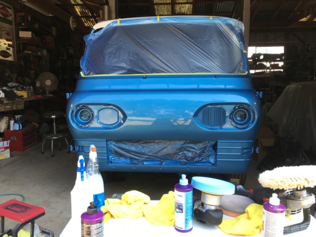

    Post by Hip E van Mon Jan 29, 2018 10:12 am
    Well I finally got to painting.  The prep was way more than I was thinking.  It’s hard to tell in the pic but this is a big improvement.  I lowered the amount of fluid and increased the pressure, this resulted in less orange peel and drastically reduced fish eyes.  Color molting is still a bit there, even tho I did a drop coat at the end of the blue, but it’s much more livable.

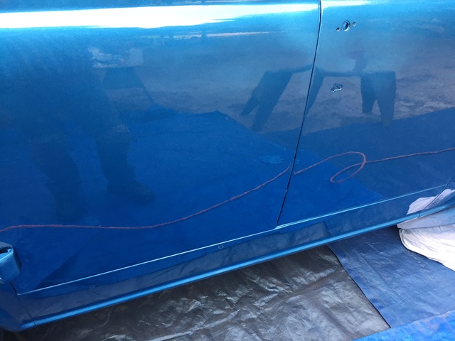

    Post by Hip E van Mon Jan 29, 2018 7:19 pm
    So I walked back down after getting some breakfast and posting that pic.  Everything was fine when I left.  Maybe a half hour had passed.  Clear coat runs all over the place!  I could not believe it, told my wife I think I’m being tested or something.  I’m gonna try a technique to sand down the runs tomorrow.  Will post updates on that.  Here’s some more pics, not the best being inside the barn.

    Post by vanny Tue Jan 30, 2018 12:38 pm
    Sorry to hear about the clear runs...Hope you get it sorted because the paint job looks Super Nice! Love the color combo. cheers

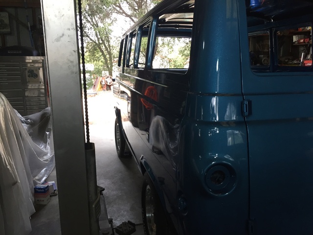

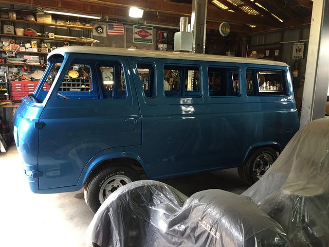

    Post by Hip E van Fri Oct 26, 2018 8:48 am
    Oh man, I haven’t posted in forever.  So I ended up redoing the paint yet again!  There were some problem areas on the front fenders and the barn doors.  I bought new paint from Summit, painted the bad panels and then found that they must have slightly changed the color!  Totally stood out when you saw the old paint and the new side by side.  Frustration levels were sky high but what are you going to do?  Also ended up not going with the extra flake as that was adding to my problems.  Here’s some pics after color sanding and buffing
