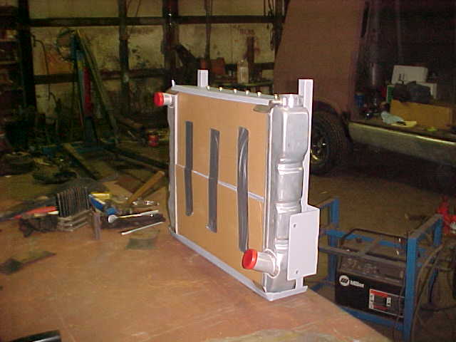

- Post n°70
Re: Digz's 65 panel
Well,, I bought a aftermarket online , Im only hoping it does the job, either way gonna be in a position to find out.
Its a 2 core 24x19 aluminum, I have a 16 inch electric fan im gonna try. only thing is Im going to have to install a seperate tranny cooler, it almost the same surface area as the original Rad, ,just hoping its alot more efficient.and opening up a tunnel for air to.
There sure isnt a whole lot of room to accomplish an overkill

- Post n°71
Re: Digz's 65 panel
WOW Digz,
Looks great. Sweeet lookin bracket. A lot of thought went into that one, good job! Keep the pic's coming....
- Post n°72
Re: Digz's 65 panel
Digz great design on the Rad bracket, that something I need to do for my Doghouse design I'm doing.
Where did you get the radiator and how much???
- Post n°73
Re: Digz's 65 panel
Im not sure how it would work ina 1st gen ,but as long as your going with that 2nd gen doghouse it might make sense to check on the radiator swap too, I havent looked at the 2nd gens much in that area, I think I know a guy who has all of that to. !! Isnt a 2nd gen radiator 28 inches wide? I know theres only about 30-31 inches between the frame flanges on mine , If you think a stock parts swap would work ,I bet it would be easier than fabbing up
all that and you still could have a transcooler built into the system. I was just working with what I had,for brackets, it gets tight over there by the master cylinder
without shipping the radiator I got was 139$, fan and switch was about 65, but its a made in china thing ,,, had to,, my wallet was grumbling. Even at 24 inches wide i had to shave the rightside original braket to make my rig fit,
- Post n°74
Re: Digz's 65 panel
where did you get it Summit???
