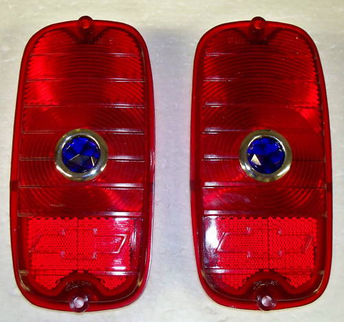

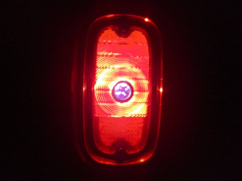

You should either paint or tape thar chevy emblem in the lens silver, I think it would even look nicer, BUT those already look very nice... and a very fair price
Joe Van- Moderator 1st Class
- Number of posts : 4619
- Post n°60
Re: Joe Van's 1966 GMC Handivan
YEA I thought the same thing I have also seen the ribs painted silver too but the Van is a GMC and haven't decided what to do yet.I will decide after I put them on and see what they look like....................
- Post n°61
Maybe find someone with a real steady hand to pinstripe GMC in the middle of the Chevy symbol!? Anyway. They'll look cool all lit up!!!

you can wet sand the lenses with 600 to get rid of the bow tie. then clean and clear coat! this will also work for dull plastic headlights.
- Post n°71
THANKS GUYS I am still trying to convince my wife all stuff I have bought for the Van the past few months had to be done and I had no choice:lol!: ..Cant buy any parts this week I will have to break down and go to the grocery store wife says no food in the house DARN I hate wasting money.!!!!!!!!!! That is a old school trick jimthefred about clear coating the lenses I did it to my 66 nova I had and they looked like new. I am still thinking about painting GMC in the bow tie. Last night I found a new set of lenses with the glass blue dots and no bow tie after I put mine on. ..(anyone want to buy a set of blue dot lenses with bow ties?) I am going to take some pictures of the Interior to show everyone my starting point. I have decided to run the toung and groove wood front to back I am a Mechanic and not a Master Carpenter and will be WAY more difficult any other way (up and down or on a angle) I am going to start with 4 of the 4x6 rolls of 1/2 in jute padding with the foil on top for the walls about $24.00 a roll from NPD I used it when I built my 41 Willy's and it is the BEST Quality looks like the factory stuff under the carpet used in today's modern cars.I will put something else on the roof that does not get affected by moisture so maby a roll of bubble stuff from Lowes theres to much humidity here to put cloth type insulation on the roof. I will use 1/4 inch oak ply wood for the door panels and rap them in padded marine grade vinyl (have not decided Red or Black yet). I think for now it will at least look better with the door panels and insulation installed.!!!!!!!!!!!!

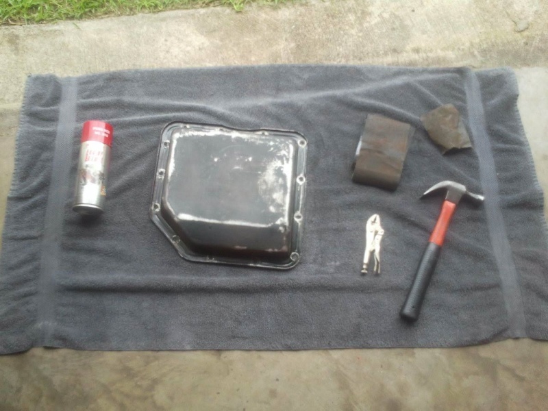

Going to fix the dents on the origional trans pan for that trans and paint it today Ford Red it matches my Van to a tee..(Go Figure)..And take that @%$#@ chrome one off that leaks like a siv even after I ground all the chrome off where the gasket sits it still leaks.!!!!. Like the Old Saying goes....Chrome Wont Get You Home..... Thats all I plan on doing this weekend I have to get out of this HEAT I am in it ALL week it is 11 oclock now temp is 84 heat index is 95 already yesterday the heat index was 105 got to love this time of year in Florida.!!!!. .............
