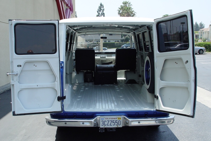

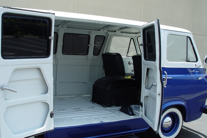

    Here are a few before pics that I took once my van was painted.
    Seat Installation 63 Falcon Bus Painte29
    Seat Installation 63 Falcon Bus Painte30
    Seat Installation 63 Falcon Bus Painte31
    I pulled two third row seats from two Ford Aerostars at a local Pick A Part salvage yard. Each one seats three people. I had to modify the brackets on each of the seats. The stock brackets were the hook type brackets that attached to a bar that was beneath the floor pan. Each seat was $40 including seat belts.

    The seats measure 52 inches wide and when both seats are reclined flat it makes a bed that is 75 inches long. The seats are bolted to the floor and the seats are removeable leaving the floor bed flat.
    I plan on installing hard wood floors next. The hard wood floor will be flush with the top of the square tubing brackets on the bottom of the seats.
