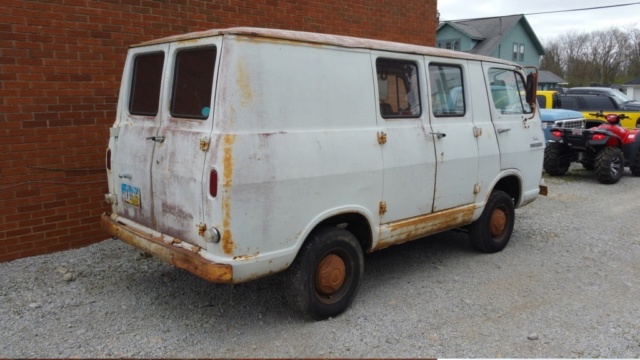

    After 2-3 years in storage, Picking up van
     66 CHEVY GETTING STARTED 66chev94
    1 of my best buds left me his 1966 chevy g10
     66 CHEVY GETTING STARTED 310
    After dropping the the gas tank and replacing the fuel pump she started. Very surprised
    I didn't have to rebuild carb.
     66 CHEVY GETTING STARTED 66chev96
    Now wheels,tires, exhaust and get her to another buds place to start blasting
     66 CHEVY GETTING STARTED 66chev97
     Only a small hole by the gas lid and little bondo in back corner.

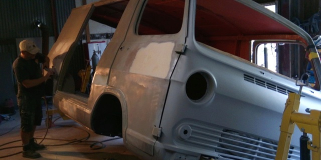

    Get engine, trans and suspension out, get her ready to blast bottom
     66 CHEVY GETTING STARTED 66che100
     66 CHEVY GETTING STARTED 66che101
     66 CHEVY GETTING STARTED 66che102
    seal up under side
     66 CHEVY GETTING STARTED 66che103
     66 CHEVY GETTING STARTED 66che104
     66 CHEVY GETTING STARTED 66che105
    body time
     66 CHEVY GETTING STARTED 66che106
    I Reimported your pics to 640 pixels so the pics wouldn't get cut off...You really went to town on this Beauty!!!Can't wait to see more! ---Vanny

    Nice having a rotisserie to be able to access those hard to reach areas! Not as easy when you have to crawl around on the ground...
    Looks Nice and solid. Are you going to stay with white or do you have something else in mind? Curious minds want to know...scratch What a Face Question
