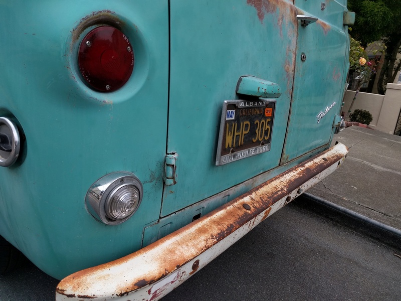

    I'd like to contribute a piece of info about the reverse/backup lights on our vans that were equipped with these. Maybe this is common knowledge, but it took me a while to find it and I thought others might be doing the same search I was. I read somewhere that the lenses for these lights were also used by Jeep Cherokees around '67-'69, and possibly other applications as well. I found the lenses after a quick search on Amazon and ordered them, thinking if they didn't fit at least they'd be easy to return. But they fit perfectly. I don't know if they differ in some way from the original Ford lenses, but they are a heck of a lot better than having no lenses and at $30 a pair, a lot cheaper than the $60 lens someone is selling on eBay right now. Here's a link to the part on Amazon (there are surely others out there).
    Omix-Ada 12405.04 Combination Park/Turn Signal Light Lens
    https://www.amazon.com/gp/product/B000FPYFIS/
    And here are a couple pics I took of the lenses installed (and one gratuitous one of our scruffy van the day I picked it up).
    backup / reverse light lens Img_2010
    backup / reverse light lens Img_2012
    backup / reverse light lens Img_2011

    Sorry just saw your question! I have no complaints about these lenses, the plastic seems beefy and the fit is good. There is a metal clip (like a C-clip) that retains the lens but the clip is not included, so if you have reverse lights but no lenses, hopefully the clip is still in the housing somewhere.

    acurtiss wrote:Sorry just saw your question! I have no complaints about these lenses, the plastic seems beefy and the fit is good. There is a metal clip (like a C-clip) that retains the lens but the clip is not included, so if you have reverse lights but no lenses, hopefully the clip is still in the housing somewhere.
    Any pic of that clip , I have the housing but I think the clip is missing. Thanks
