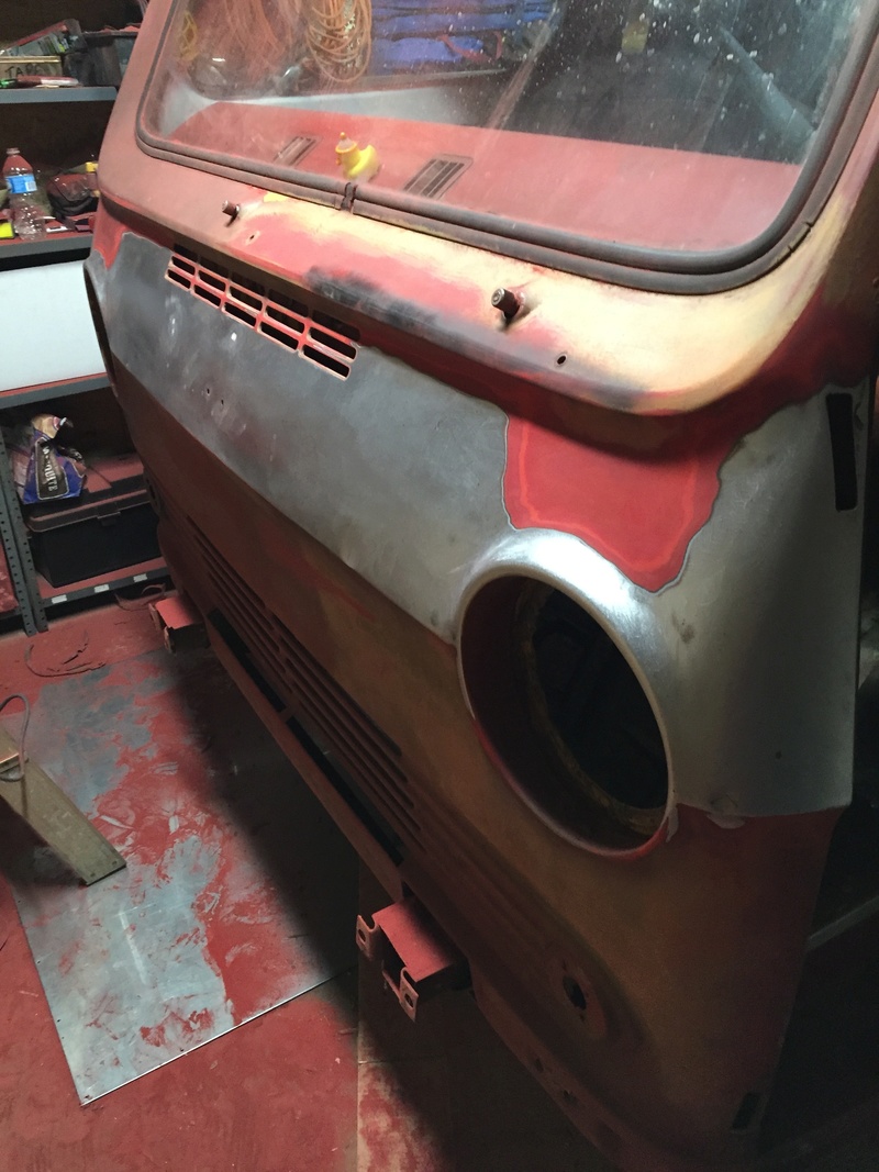

    1966 sportvan build Img_0410
    top of windshield had some rust issues so cut that out and with the help of some eastwood shrinker stretcher rebuilt that
    1966 sportvan build Img_0511
    cut out the quarter panel and rocker to find all supports plus floor had rust so rebuilt from inside out

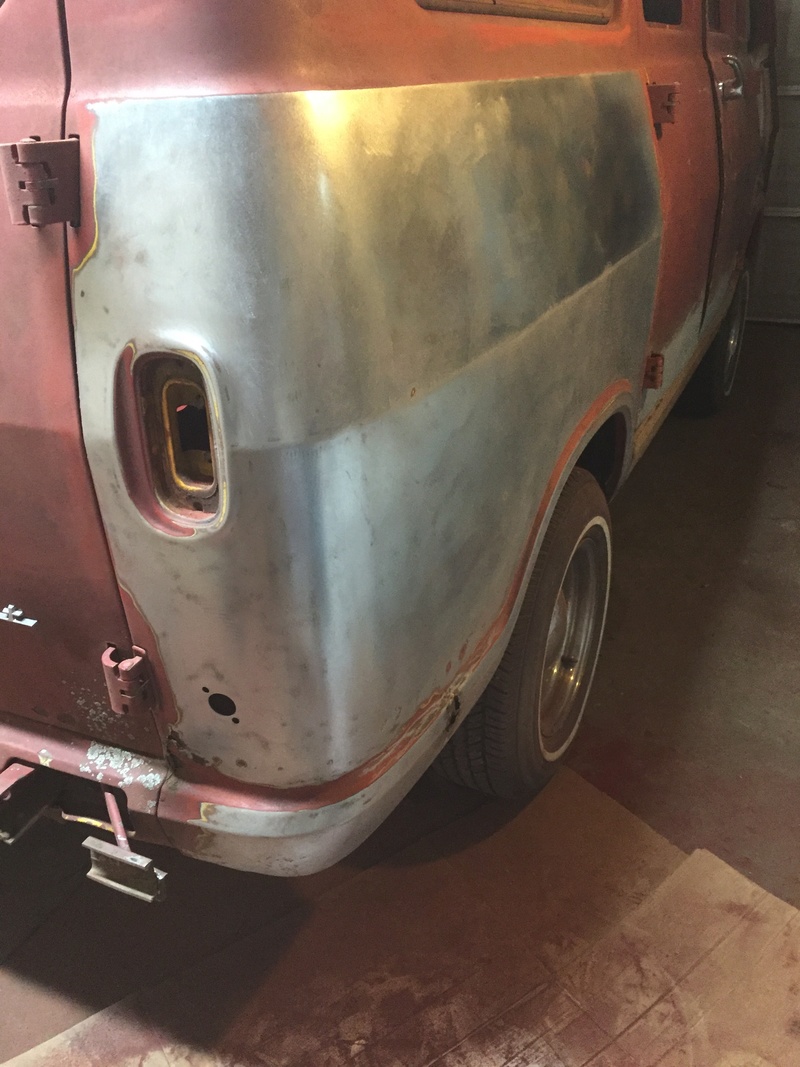

    could only find quarter panel from 2nd gen but got it on
    1966 sportvan build Img_1210
    smoothed the parking lamp off quarter as well as gas cap because i will be moving the gas filler to behind the rear tail light 1966 sportvan build Img_1112
    also i have been welding all seems on the van completely smooth

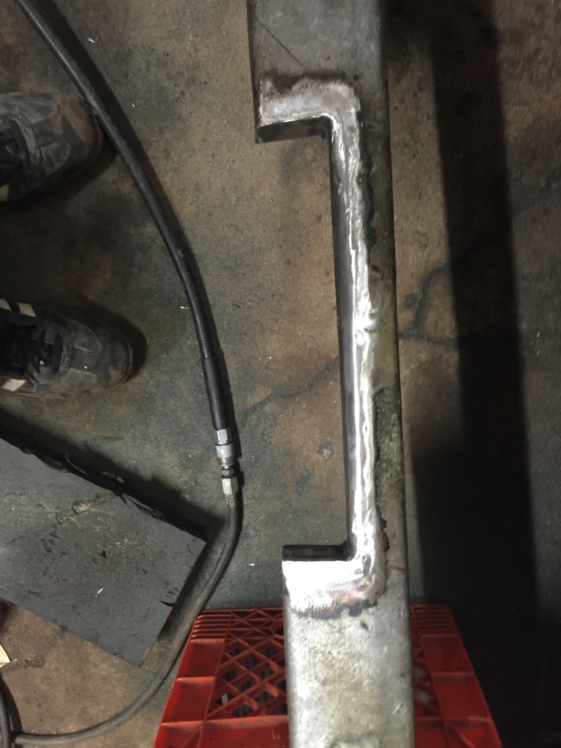

    so i sucked in rear of frame to mount bumper closer to body had to shorten width by two inches and then built a cutout area for license plate
