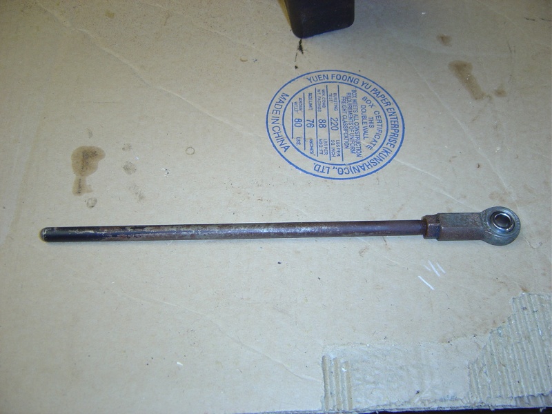

    The bracket is easy to make but it does position the master cylinder back. I also had to space the sway bar down 1/2". I have one bracket left that I made that just needs to be drilled. If you have disc brakes use a 77 Maverick manual disc brake master cylinder, for drum brakes use a 77 Maverick manual drum brake master cylinder. You will also have to make a longer actuator rod or buy one from total performance. They aslo sell a tee fitting with the propr outlets to mount a pressure type brake light switch.Here's some more photos of the bracket. Mine has been in use for over ten years with both drum and disc front brakes.
