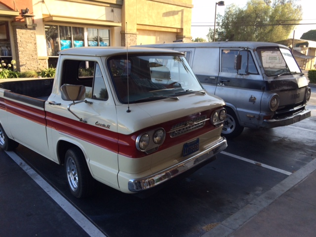

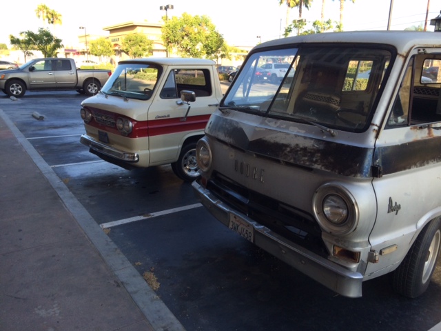

    went to o'Reilly to get a couple parts. this pulled up right next to me!
