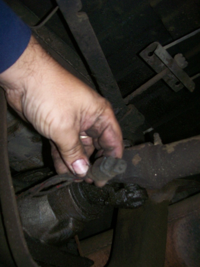

    Drag Link with curve in it (Econopoor - Supposed to be there or not?)
    Vanny's Diamond in the Ruff! - Page 2 100_7115

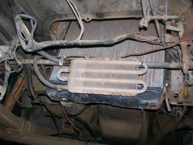

    Transmission Cooler (Just realized I'm going to need a belly pan)
    Vanny's Diamond in the Ruff! - Page 2 100_7116

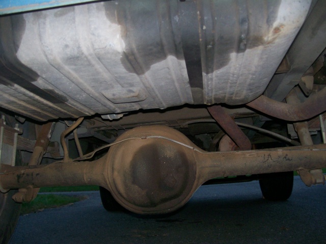

    Rear End (Wet spot on gas tank are the nuts soaking for removal)
    Vanny's Diamond in the Ruff! - Page 2 100_7117

    Drag Link with curve in it (Econopoor - Supposed to be there or not?       IT looks like its bent pretty good too me Those adjusting sleeves should be parallel with the axle no big deal just install a new one (Center Link) and get a Front End Alignment done I see it all the time with tow truck drivers not knowing where to secure it down with out damaging it I see it alot with front wheel drive cars also in the rear.!!!!

    @ Joe - Yeah, that's what I figured, the shiny spot where the chain was hooked on in the middle of the curve gave it away.

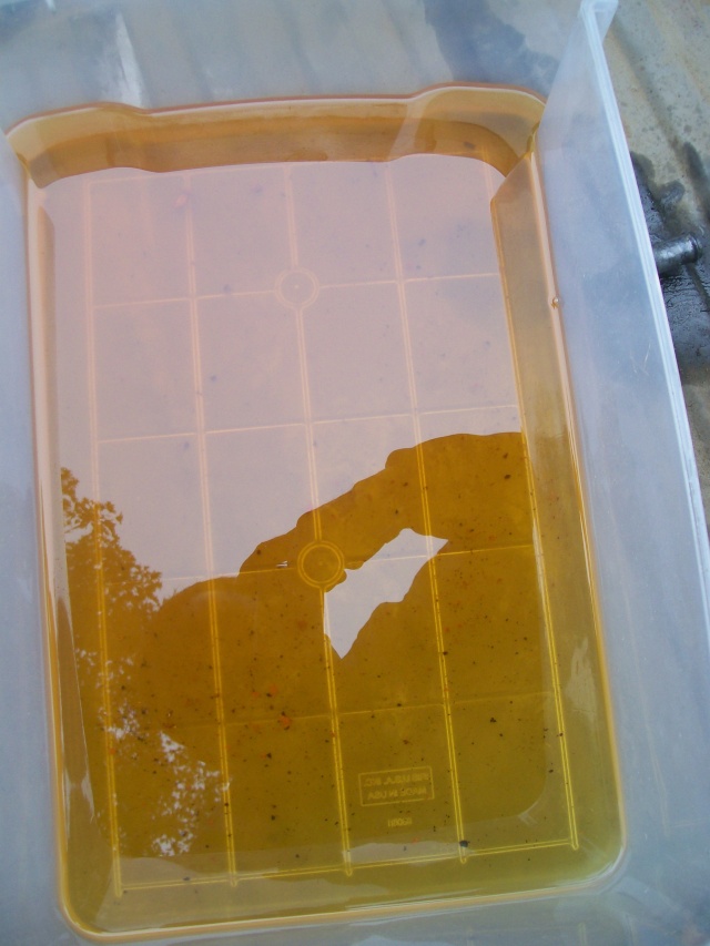

    Just got back from Disney last night. Wife is still visiting in Florida. Told grandson he could play on the computer today while I did a little work to the van. I got the gas tank out and emptied the gas. Looked clean coming out but the container had little black chips in the bottom. While following the fuel line, I found a few things I have questions about. I'm not a mechanic and need some assistance in identifying the things I found along the way. Thanks in advance for any help!
    Vanny's Diamond in the Ruff! - Page 2 Old_ga12
    Old Gas with gunk in the bottom.

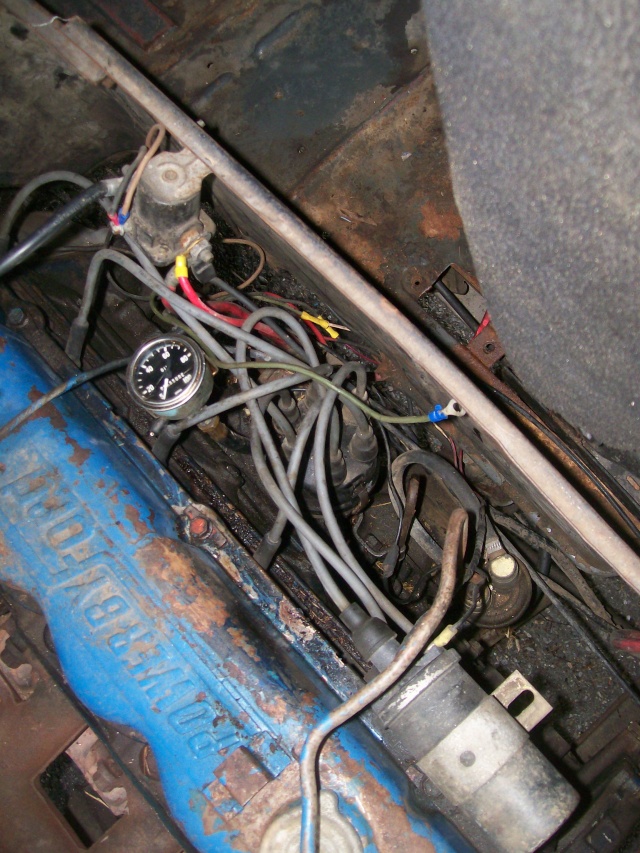

    While cleaning nesting material from the engine, cleaned what appears to be some kind of oil pressure gauge. Has rubber tube that goes to bottom of block on driver's side and one wire goes somewhere underneath. there is a threaded post with no wire but a nut on it. I also saw a red wire coming from the voltage regulator? that wasn't connected to anything. Could this go to that gauge? Why would this gauge be just sitting there?
    Vanny's Diamond in the Ruff! - Page 2 Oilpre12
    Vanny's Diamond in the Ruff! - Page 2 Oilpre13

    That is a fuel filter on the end of the hose that goes into the carb,,,,,,,to the rear of the #6 spark plug, is the temperature sender,,,,,,,below it is the oil galley port where you hook up the wire or line for the oil pressure light or gauge,,,,,,the trans might have wires or switches for  back up lights or a safety neutral switch.......

    Surprising the gas does not look too bad and VERY minor settlement in the tank if there is no rust inside I wonder if it is really necessary to coat and reseal the gas tank you might just be able to clean it out and fill it with fresh gas.!!!! I have seen gas tanks where the gas is black after sitting a couple of years and a inch of rust inside.Smile ...........The ethanol is killing our fuel systems here in Fl does California have it in there gas???? It does not look that bad at all after sitting all that time............
