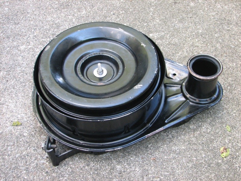

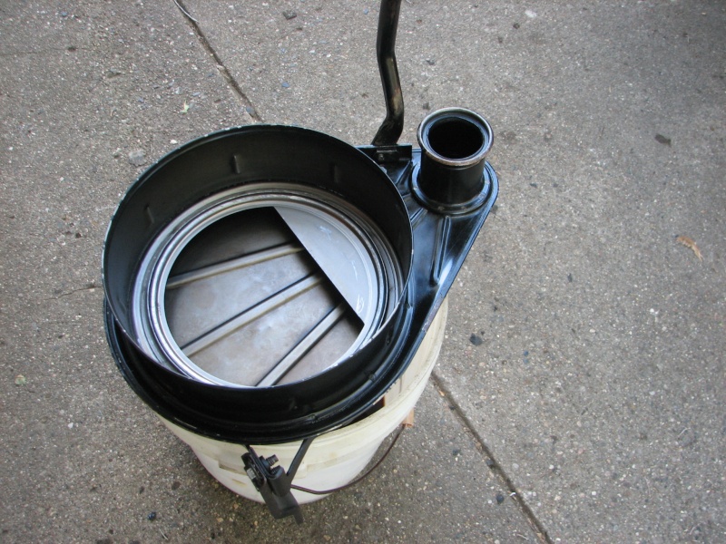

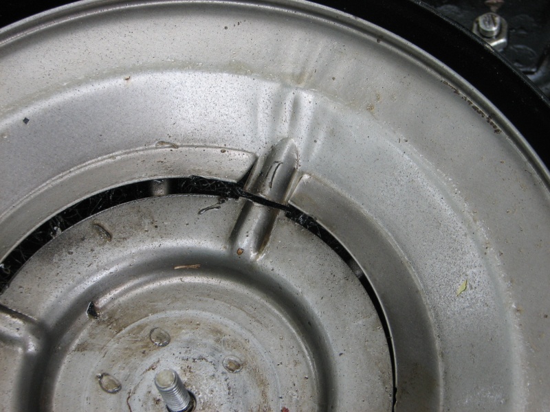

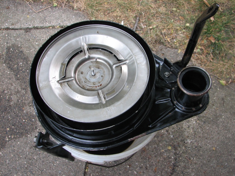

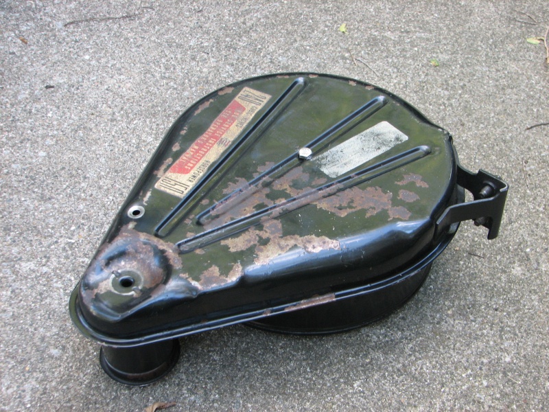

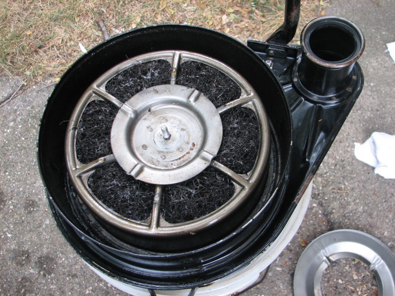

Converting Oil Bath Air Cleaner
Taking the idea from EconoCarl on converting our oil bath cleaners to a paper filter here are photos of the project. The inside is all formed together so it needs to be cut apart.I did all the cutting with my Dremel tool with a metal cutting wheel. A word of safety, let as much of the old oil to drain out, although not super flammable you will be causing sparks so use some caution. The air filter is from NAPA # 2055
