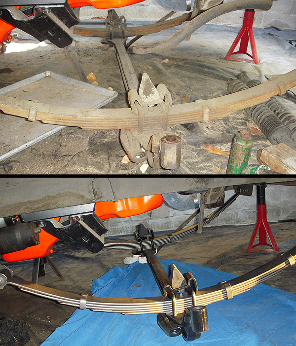

    Back to......VANagains NEWest 65 Chevy SportVan Deluxe - Page 5 Empty Front End going back in
    Post by VANagain Sat Dec 26, 2009 1:16 am
    I've got some time off work and in between shopping and other holiday distractions, I've been able to get some front end parts put back on. Here's a before and after shot of the leaf springs and axle:

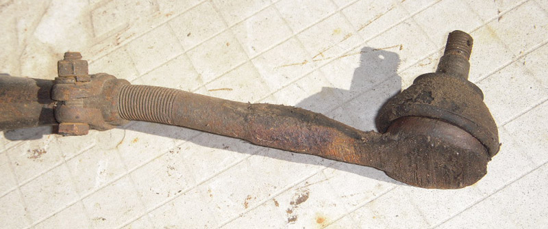

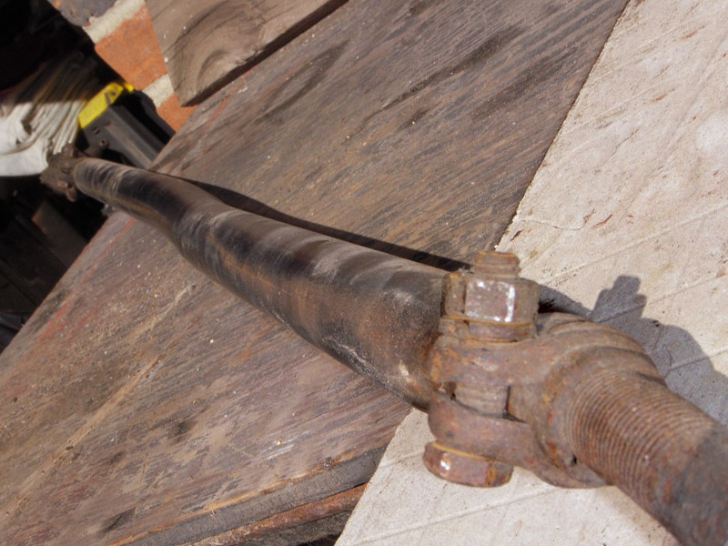

    Hey, check out my steering link. Is it supposed to have this subtle bend in it? You can hardly notice it except when viewed straight-on like this:
    Back to......VANagains NEWest 65 Chevy SportVan Deluxe - Page 5 Fronte11
    I have found some evidence of of some bumps and scrapes under here. One of the U bolts was bent, along with the anti-sway bar mounting bracket. And look at this tie rod end. How long would you say since it was last lubed?!
