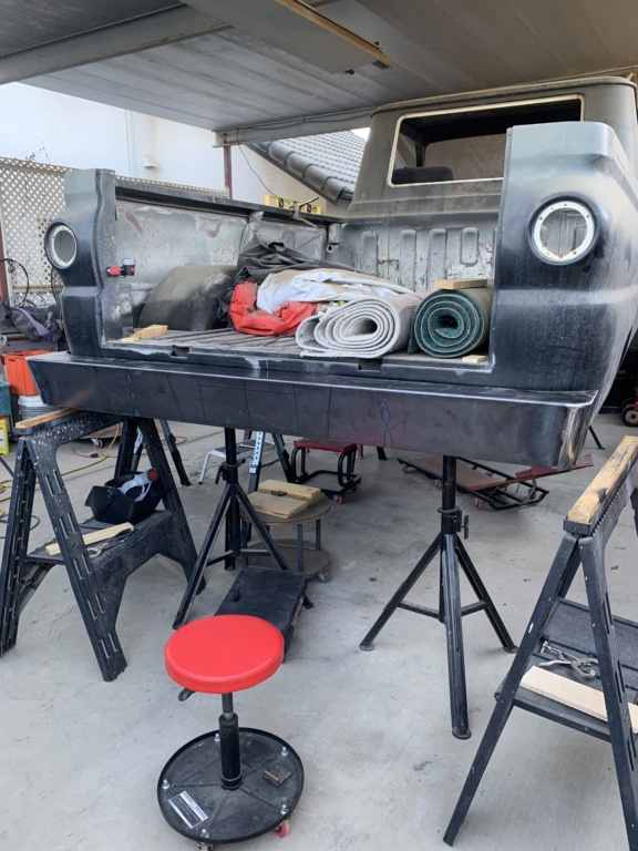

    I’ve been working the past 2-3 weeks on some new bumpers. As you all know stock bumpers are near impossible to find. I decided to make my own. I had a local steel shop bend some 10 gauge metal to the shape I wanted and proceeded to make my own design. I think they turned out pretty nice. I know they sure are heavy.
        Prior to the bumpers, I spent quite a bit of time putting electric power steering assist in the truck. This turned out to be quite a lot of work. There are no direct bolt in kits, so I had to do a lot of fabrication, lots and lots of it. Some time ago I had put independent front suspension in along with parallel 4 link in the rear with air bags. Tons of work and a lot of head scratching!
        Over the course of my rebuild I given a lot of thought where I’d like to end up with my truck. Don’t laugh, but I think I’d like to make a “tow truck” out of it. Kind off like “Mater” in the Cars movie. Really won’t be able to tow with it, but I think it will look kinda neat. I try to get pictures posted when it’s done. Patience please.New front and rear bumpers 1d122010

    Never did weigh them, but the rear one is pretty big. If I were to guess, I’d say 30-40 pounds, maybe a bit more. That would include the new mounting brackets I made from 3/8” thick steel. Had a local shop water jet cut them. Quite a process to watch!

    Appreciate the comments guys. It’s been a bit of a chore, but I like the challenge. Right now I’m trying to figure out some sort of non slip surface for the back bumper. Thinking of expanded metal, but not real thick, maybe 16-18 gauge. I’m also going to put a license plate pocket in the back very similar to the front. Seriously considering a hidden receiver hitch as well. Bit of a head scratcher there!

        Made a few changes on the back bumper. Decided on a hidden receiver and expanded metal. I’ll add a flip up license plate holder later. I’ve really been enjoying working on this lately.

    Flip up license plate will hide receiver hitch when not in use.

    Got the bumpers and hitch sand blasted to clean them up. Welded the expanded metal on the rear bumper and put a little primer paint on temporarily to protect from surface rust until I’m ready to get them powder coated. Thinking of a color called extreme chrome. Should look pretty good. I still want to mount some fog lights recessed into the front and some good size lights in the back when in reverse. Still got some shopping to do for those. If anyone has any suggestions, I’d appreciate the feedback.

    Thought I’d tidy up the corners. Looks much better.
