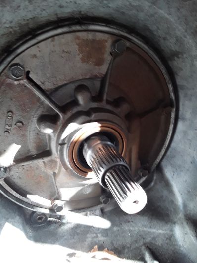

    Post by dix Sun Dec 02, 2018 5:58 am
    the tranny on the right has a long tail and has no dog bone on top meaning you would need a cross member and a lot of fab work to be used
    the one on the left looks more realistic but the trans shaft on both do not look correct. i will try to post a pic today

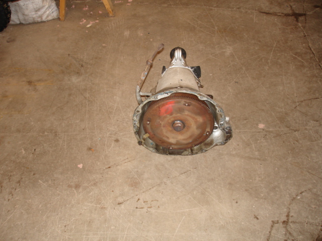

    Here's a pic of my trans setup. Standard 727 upfront and the short output shaft; seems to what your pic shows on the left.
    Transmission for A100 needed AT_
    That means, the cam enters the trans, not the engine. phew.

    Post by Thekrizz Tue Nov 06, 2018 4:15 am
    Hi took me a while to get these pics Transmission for A100 needed 29e21e10
    Transmission for A100 needed 419ef410
    they should show a long neck transmisssion with the long shaft sticking out. We would need the same shaft in the second transmission next to it which has the proper short housing for an A100. Can you guys see these pics? have no idea if these urls work.
