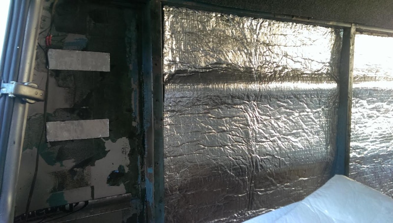

Mine has two layers of the foil bubble like in the pic above on the roof held on with spray adhesive and spun wooley carpet underlay on the walls, also glued on. I'd have used the bubble on the walls but the PO already glued the underlay in place.

Here are the photos of the "custom" kit I purchased from another member here.
The kit was made from a company in Cali that takes measurements, etc and figures out strategic placement for Dynomat.
It applies directly to the sheet metal using spray adhesive. I spoke at length with someone at the company very knowledgeable with the science of the product and etc and she indicated that direct application would not trap humidity, etc.

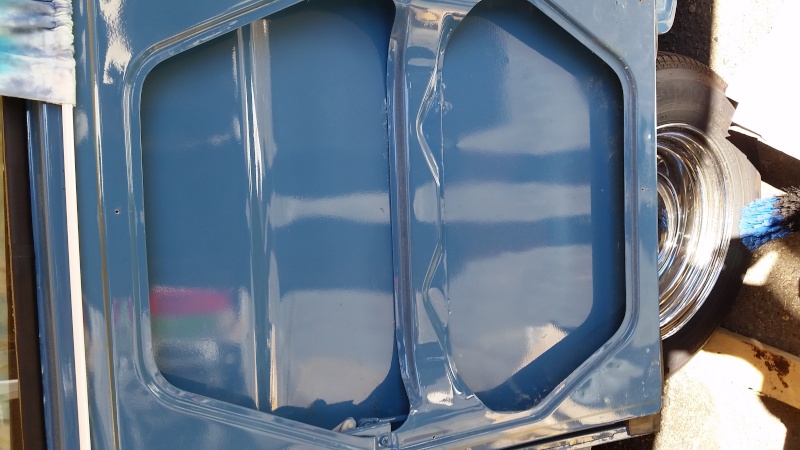

Hi. This is how I did mine, and all my other wheels as well.
I start by making sure it's nice and clean, no rust or critters:
Next I install some sound proofing material (Dynamat, FatMat...) which is simply a butyl rubber bonded to an aminum alloy skin which cuts the "tin can" effect. No need to cover everything, just some patch in the middle will do.
Next I use closed cell foam (carpet underlay from Home Depot) to cover the entire panel. It won't absorb water, easy to cut and fairly cheap. As you can see there's one side with pattern. Put that side against the panel so air can circulate between the ridges.
I finish it off with Roxul insulation. This brand doesn't absorb water or humidity like the typical fiberglass one. It's also way easier to work with and doesn't itch! I cut mine in half thickness with a large knife then add it as the next layer making sure I don't compress it.
I guess one could add a layer of poly sheet (vapour barrier) on top but in my case I just put the panel back on top and call it a day. My van is now cool in the summer/warm in the winter and very quiet.
