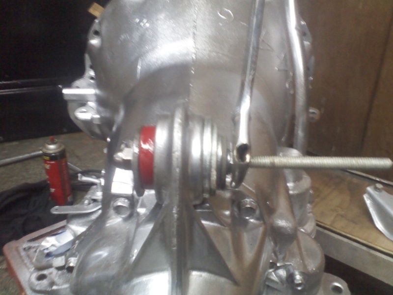

    once the old one is been removed and cleaned up,
    How to install a new tranny bushing on the a100 and the econoline 12081310
    use a all thred with washers and allign up the bushing.
    How to install a new tranny bushing on the a100 and the econoline 12081311
    then start to tighten up the all thred nut and draw the bushing in thruthe opening.
    How to install a new tranny bushing on the a100 and the econoline 12081312.
    Then use a mallet to even out both sides...
    How to install a new tranny bushing on the a100 and the econoline 12081313
