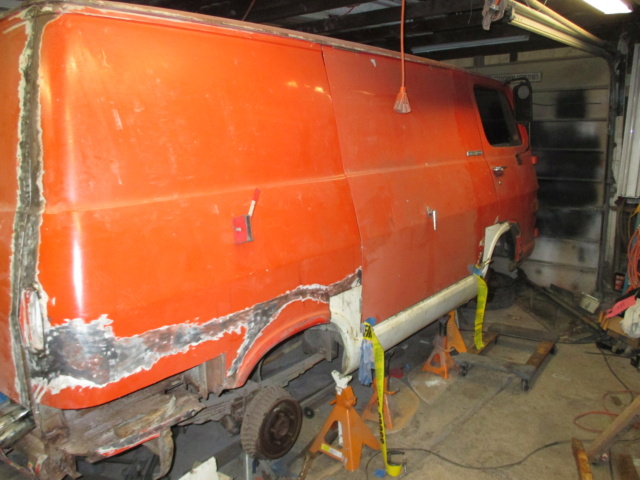

    Making some progress on pass side of 64. Also had to take All the interior out. All flat head screws & finish nailed  together

    More progress pics on the 64 Custom van
    What are you up to? - Page 21 Img_0819
    cut part of floor & inner rocker off
    What are you up to? - Page 21 Img_0820
    New(Used) CA section my Friend Mark sent me in Vanatainers (in 07 Thanks Big time Mark)
    Cutting & fitting it in, in this pic
    What are you up to? - Page 21 Img_0821
    New floor repair panel I made to fix Major rust out. (1st time I used bead roller I bought years ago) Still fitting in this pic .
    What are you up to? - Page 21 Img_0822
    Before I fit these panels

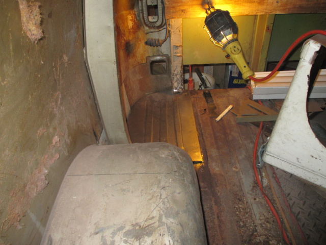

    More work on 64 (G O) pass side floor & new cooling tunnel / shifter mount
    What are you up to? - Page 21 Img_0918
    What are you up to? - Page 21 Img_0917
    What are you up to? - Page 21 Img_0916
    What are you up to? - Page 21 Img_0919
    Getting there ???

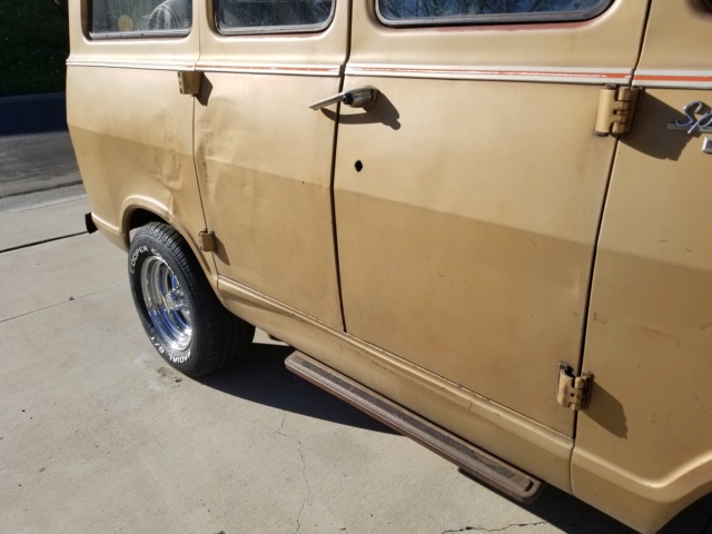

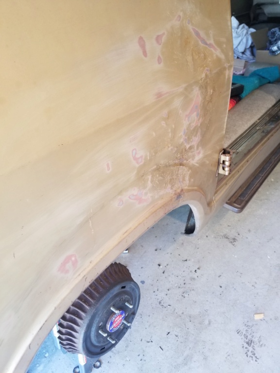

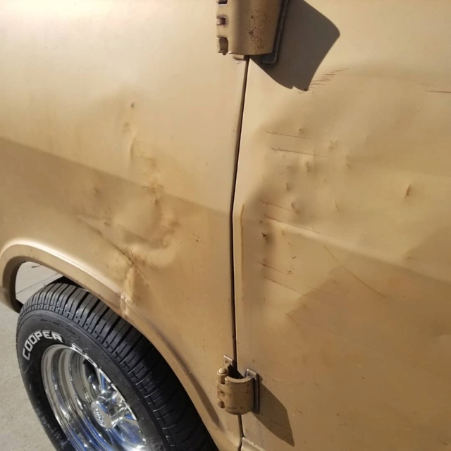

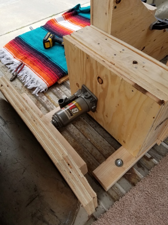

    Done a lot of projects big and small on the van during the last year and a half, currently working on fixing the sideswipe dent from a previous owner. It was made worse by some PO who tried to pound out the dents from behind with what looks to me like a regular carpentry hammer - note all the little dents.  Here is what my son and I started with:
    What are you up to? - Page 21 20200110
    What are you up to? - Page 21 Img_2010
    The fender was hit so hard it pushed in the wheel well which is spot welded to the outer skin, and also integrated into the unibody floor so I rigged up this plywood brace bolted to the factory seat bolt brackets.  I then inserted a bottle jack to push out the whole assembly.  I lost a lot of photos but I think you get the general idea.  Hard to explain but I also bolted a piece of steel to the top of the fender well so the jack was pushing equally on the lower portion of the wheel well and the top where the spot welds are.  It got everything out to normal position by about 99%.  It was a hack but I don’t have a frame straightener lying around.
    What are you up to? - Page 21 20210412
    What are you up to? - Page 21 20210410
    What are you up to? - Page 21 20210411

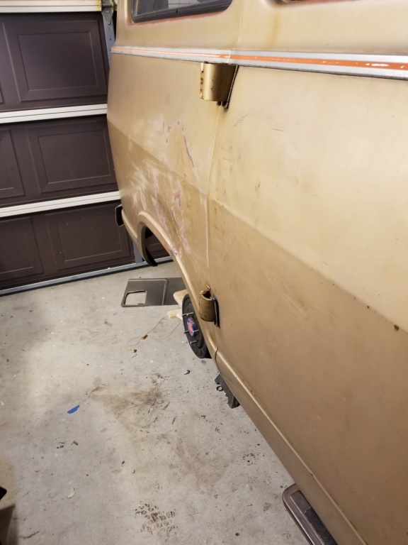

    I then proceeded to go after the high and low spots with hammer and dolly, and also had to do some torch heating to shrink one portion that was oil canning.  That last part wasn’t too pretty as I was learning as I went, but there will be no bondo filler greater than 1/8-1/4 inch and the thick parts will be small.  I’ll use the Bondo Glass with extra fibers for strength in those areas.  It’s not extreme enough to use the Bondo Glass.  Working on the door was a lot easier as I could remove it and stand it on its side.  I had to cut out a large access panel though which will be welded back in and hidden by the interior door panel.
    What are you up to? - Page 21 20210413
    What are you up to? - Page 21 20210511
    What are you up to? - Page 21 20210510
    What are you up to? - Page 21 20210710
    What are you up to? - Page 21 20210711
    Looks pretty good so far although rough.  I went ahead and hit it with some rattle can paint to cover the bare metal until I’m ready to put on the filler.  Next step is the large dent in the rocker.  I picked up a stud welder for that, and purchased a really cool vice grip for grabbing three studs at once.  I’m going to rig up my own hustler stick with my iron bar so I don’t have to buy one.  Any tips on using the stud welder method would be greatly appreciated!
    What are you up to? - Page 21 20210712
    What are you up to? - Page 21 20210810

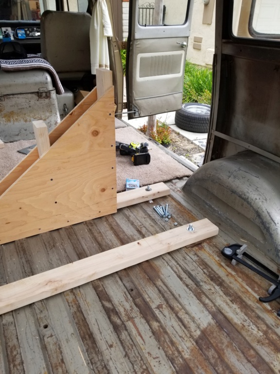

    Real nice work & Cool DIY engineering

    savage wrote:Real nice work & Cool DIY engineering
    . Gotta work with what ya got

    Oops yeah I forgot about that. On my iPad if you click on the image it will show you the whole thing.
    Here is a couple the right way
    What are you up to? - Page 21 Img_2011
    What are you up to? - Page 21 20210512
    What are you up to? - Page 21 20210713

    That’s some fine MacGyver-like engineering to get the job done! I may use your ideas to try and straighten out some dents around the nose and headlight area on mine. Thanks for the inspiring work and keep the pics coming!!! Please and Thank You 😊

    I like these Vise Grips…would love to see a pic of them in action.

    The stud welder is a good choice for your rocker crease if you can't get behind it. Just be careful to not stretch the metal by pulling too hard. If you're going to pull the nails with a slide hammer type device, go easy for the same reasons.
    You can put a row of nails in the crease itself, the closer the nails the less stretching. Grab the nails uniformly with the clamp tool and work the metal while you're holding pulling pressure so the metal will "stay". Good luck!

    vanny wrote:That’s some fine MacGyver-like engineering to get the job done! I may use your ideas to try and straighten out some dents around the nose and headlight area on mine. Thanks for the inspiring work and keep the pics coming!!! Please and Thank You 😊
    You might be able to get away with the Habor Freight hydraulic ram set with different pulling and pushing attachments.  I have a grapefruit sized dent under my passenger side headlight that is inaccessible  due to the inner sheet metal layer on the Chevys.  I think I’ll have to use the stud gun on that.
