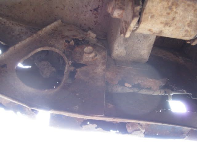

    Well, I'm at the point of no return on the exhaust... as I was letting the van warm up, I could see just how much exhaust was escaping around the manifold... my brother did not want me driving like that, so the ice cubes and ratchet came out! I think three bolts worked, three snapped, and two are apparently obstructed by the previous owner's attempt to weld the manifold while installed on the engine! Why not remove it, clean it us, weld it, and reinstall? You'll see the carnage later.
    I finished with the brakes!!! One donor hose off the 64!
    But I found the van's rust-outs... passenger floor is practically dirt Sad
    Got my 63 Merc "Grimstone" - Page 2 IMG_0091
    Anyway, I have to do some grinding to get the last tewo bolts and exhaust manifold removed, then several studs soaked and removed. Lots to do today. Good thing I'm off work today!

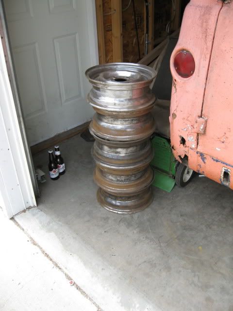

    Here's the broken down rims, still hoping to get them sandblasted soon: 4 13X5.5, 1 13X4.5 (the 4.5" is shiny clean). Once they are blasted, I can straighten the rims out and paint them! The sealing surfaces look like they have rusty bits left over from the old tires themselves... I may attack them with the grinder to see if I can clean them better. Still, there's old paint in the corners that I can't reach well...
    Got my 63 Merc "Grimstone" - Page 2 IMG_0126
    Got my 63 Merc "Grimstone" - Page 2 IMG_0118
    Still stripping parts... off the Ford for donations, off the Merc to prepare for bodywork. Slowly it moves along.

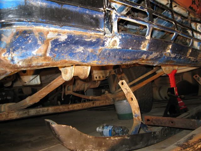

    I'm preturbed though... the weather is not cold here yet, but as I am under the van working with a spotlight, I see a mouse crawling along the wall a couple feet away from me! I'm a big baby with that stuff! So I have to get some traps and build up my courage to go and lay on the floor again!
    Basically, I'm stripping out everything underneath the Merc (pedals and linkage, steering left). My gf will get the gas I drain out of the tank so I can drop it too, as well as that big weight above it! I started brushing accessible areas of the underbody, and will have a little banging and pulling to tend to some dings. I'll have to fix the rear bumper mounts inside the frame, as three bolts broke. Couple small holes to weld up in the floor. With that done, I have major work on the front passenger floor before I can paint the undercarriage.
    With the Ford, I'm stuck on the steering, but don't think it will be a problem when I go to pull the motor.

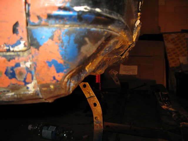

    Have to remove the "chin" below the grille, but not sure how to get at all the spotwelds. This one is bashed up pretty good, and I can't unbolt the grille. Any deconstruction tips? Also don't want to ruin my donor panel.
    Got my 63 Merc "Grimstone" - Page 2 IMG_0127

    THE DEMISE OF THE 64 FORD: WHY IT WAS SACRIFICED
    Got my 63 Merc "Grimstone" - Page 2 IMG_0160
    A peek behind the front passenger wheel... notice the 2X4 sandwiched between the motor mount arm and the floor... probably preventing the engine from dropping on to the ground.

    Here is the forward leaf spring perch on the drivers side rear axle. Why am I just now realizing that the perch is virtually separated from the frame, three 2X4s holding the floor up off the axle?
    Got my 63 Merc "Grimstone" - Page 2 IMG_0167
    After removing some of the tin hiding the rot here, the wheelwell is separated from the floor (that which remains), and the fuel filler box is severely rotted. That theme continues around the the base of the door pillar. I didn't realize it would be that bad...
    Got my 63 Merc "Grimstone" - Page 2 IMG_0170
    I didn't bother removing any more tin... certainly this is hiding more of the same. So you see, the Ford is too far gone. It's parts will live on.

    So after the 64 moved out, I took a pic of the Merc, but wearing the Keystone Klassic shoes...
    Got my 63 Merc "Grimstone" - Page 2 IMG_0179
    When I had checked them on the Ford, it looked like I was going to have to radius the outer wheel wells to get them to fit. However considering the shape of the spring perches, I thought I would see how they look on the Grimstone van (man, I can't wait until I can stop calling it that...) Now, there's no gas tank, axle weight, engine or tranny. Still, I think it will work! The fronts barely clear the steering linkage!
