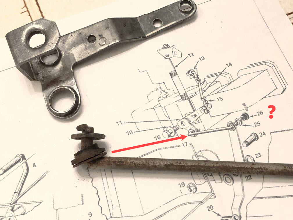

    When I first restored my van, I replaced all the various grommets, bushings, and washers on all the carb linkage to try to tighten things up. 12 years later it’s time to do it again. But I’m having a heck of a time finding this type of grommet! It has a metal sleeve/washer with rubber that tapers to fit into the “rounded” hole in the bracket.
    Can’t find Accelerator Rod Grommets Carb_l11

    But just now I took a closer look at the diagram in our maintenance manual and their drawing looks just like the one that keeps showing up in my searches!! So the correct part has been staring me in the face all along? The diagram makes it look like it just goes alongside the bracket, which wouldn’t work. So, what, do you work the rubber ring into the hole and the inserting the plastic sleeve keeps it from coming out?
    Can’t find Accelerator Rod Grommets C0fc8610
