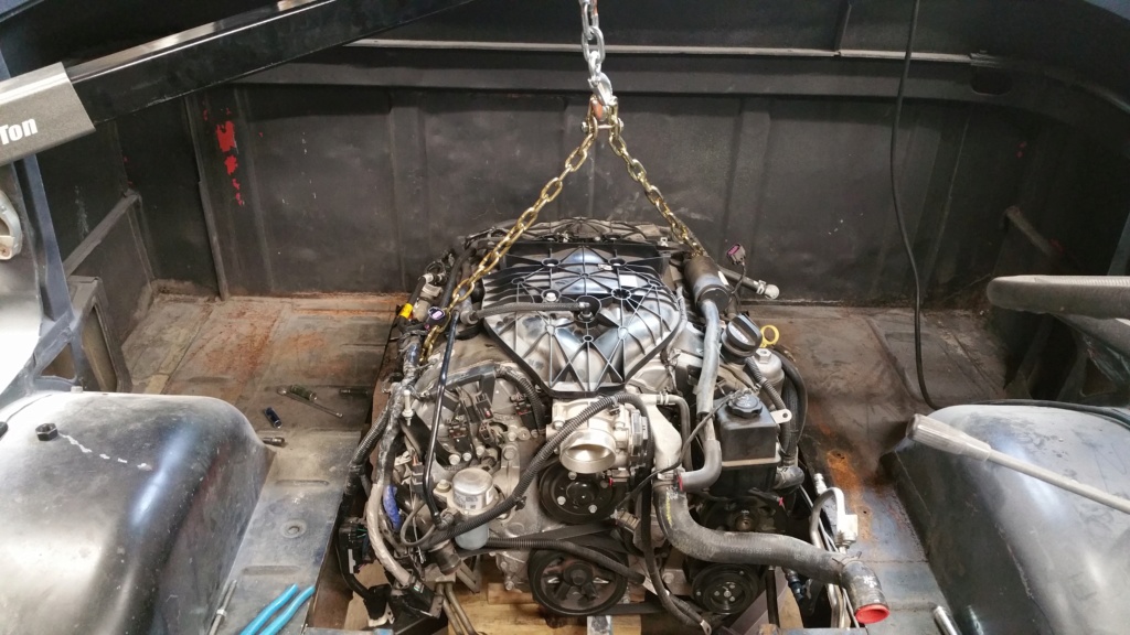

    Well, this project has been going on for the last 5 years, recently installed a '14 camaro 3.6 v6/6-speed auto. I will be working on this again next year hopefully next spring and get it on the road next summer. Some interesting facts- the ford 6 cylinder/manual 3 speed weigh 481 lbs, without the alternator so its around 500 lbs for 80+ hp and 3 speed manual. The '14 chevy LFX 3.6 v6 with 6 speed auto weigh 20 lbs LESS and it makes 323 hp! and you get 3 more gears. Anyway, I don't have the latest pictures, I am not the best at taking pictures of my projects but Ill keep updates on here this winter.My '64 Econoline pickup 20180413
