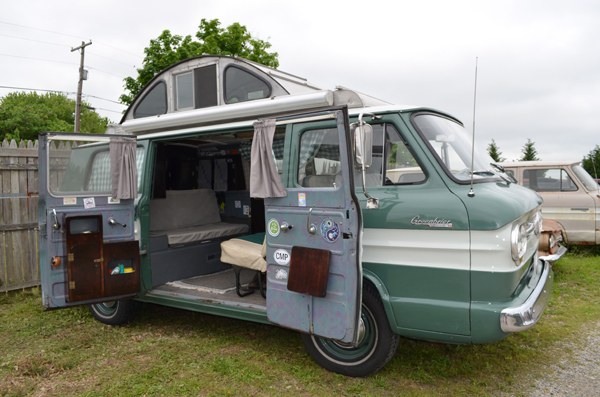

    I have a TEC topped van...although it is a 1962 Corvair van.
    Here is my website- probably the most comprehensive spot on the net for these tops. I have owned all three types as well over the years. Mine has three windows per side. It also has a non-unitized frame. It is made of lots of pieces of what was originally wood- now plastic lumber- covered with aluminum flashing.
    It took us many hours to install on my van- but it was one piece at a time and the van did not originally have a top.
    http://bensbus.zxq.net/TECtops.htm
