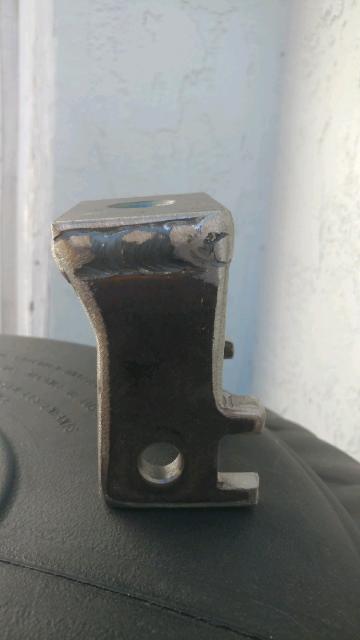

    Thanks to the design skill of Rich (VanAgain) and Spinner a local vanner who runs EisWerks in San Diego
    my new sway bar brackets are finished. I will now be able to fit the 2nd Gen sway bar around all the additions up front of PS and Disc Brakes. If anyone needs original 2nd gen brackets mine will be for sale.

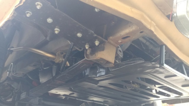

    Post by JackeFriend Sun Feb 28, 2021 11:28 pm
    Today I was able to go over to see Rich and work on getting those special new brackets fit for the 2nd gen sway bar to clear all the added PS and Disc Brakes and Dual master. Rich had to make some adjustments to the bracket for fitment. A little grind here and little grind there...
    Clearance between PS and the bracket with wheels turned all the way to the left:
    GMC Jacke's van - Page 4 Top_vi10
    This picture is of the entire link top to bottom:
    GMC Jacke's van - Page 4 Top_to10
    Heres the view front to back showing where the disc brake caliper clears the bracket. It's actually the connector bolt that we had to make room for.
    GMC Jacke's van - Page 4 Top_vi11

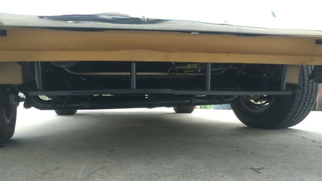

    Post by JackeFriend Mon Mar 08, 2021 8:13 pm
    So we got the Belly pan on as well as the sway bar. I dropped the front of the belly pan 3" to get extra air flow. I have the temp down with the added tunnel and a fan attached to the radiator plus the 3" dropped front. The second picture you can see the sway bar and the bracket that holds the Power booster for the Disc Brakes. cheers
