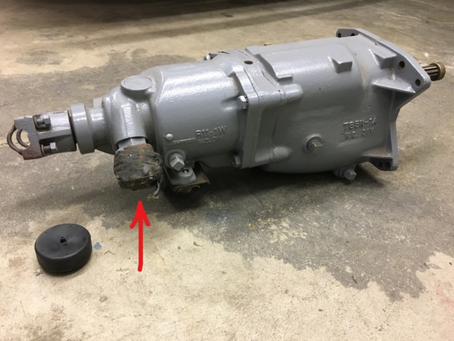

Over the holiday weekend I did some shuffling of vehicles and brought the van into the shop. What I’ve got in mind is a transmission swap- removing the 3 speed for an overdrive 3 speed. I mentioned this gearbox earlier and after taking some measurements and some eye-ballin’, it looks like it will work nicely. Here’s what I’m working with:
(photo)
It’s a BW T85N with the R11 overdrive on the back of it. This is most likely out of a Ford truck from the 60s or early 70s. The R11 is the heavier duty OD of what was used in ye olden days as it was available for big-block cars and trucks. There was a R10 OD used in older cars (the R11 has four planetary gears @ 28% vs the R10s three @ 30%).
This side shows the governor switch which will energize the solenoid at around 27 MPH and encourage a shift into OD; if the vehicle slows to under 27 MPH it will pull the transmission back into direct drive. Pushing in the clutch is not necessary for this shift to occur, just lift the gas pedal to take the load off the drivetrain. The round rubber object is a boot for the governor that 5th Avenue Garage repopped; they said I bought the last one in the country!
On the driver’s side is the solenoid that performs the shifting. I have all the relays and wiring that would have been installed in a vehicle to make the transmission work properly, even the cable that would be on the dash to “lock out” the OD and keep the transmission in direct drive. I’ll try to retain all the features that give a driver this transmission’s benefits. There is also a “kick down” switch feature that will make the transmission downshift into direct drive on command if the driver floors the gas pedal.
The T85 won’t simply bolt to the bellhousing in my van even though they both share the Ford “narrow pattern”. The input shaft is a little long and there is some disparity in bearing retainer size. I’ve been talking with Modern Driveline about some of their adapters being used as a spacer and just bolting through it. I need to take some careful measurements once the transmission is removed, but I think this strategy just might work.
(photo)

Tonight I took the overdrive apart to inspect the innards. I drained out only a few ounces of oil from the OD unit which was concerning as that’s the death knell for them. Everything looks good inside with only ordinary wear evident to my eye, so that was a big relief. Hopefully, the oil just leaked out during the years of storage through some leaky seals that will get replaced now.
I have a factory 1965 Ford truck service manual that includes this transmission. The gearbox passed all the diagnostic tests listed in the manual so I'm feeling good so far. The gizmo on the end of the shaft is the free- wheeling unit, or overrunning clutch which has some rollers that climb ramps and wedge themselves into the bowl gear. There were a couple of fun springs inside of that to put back together.
