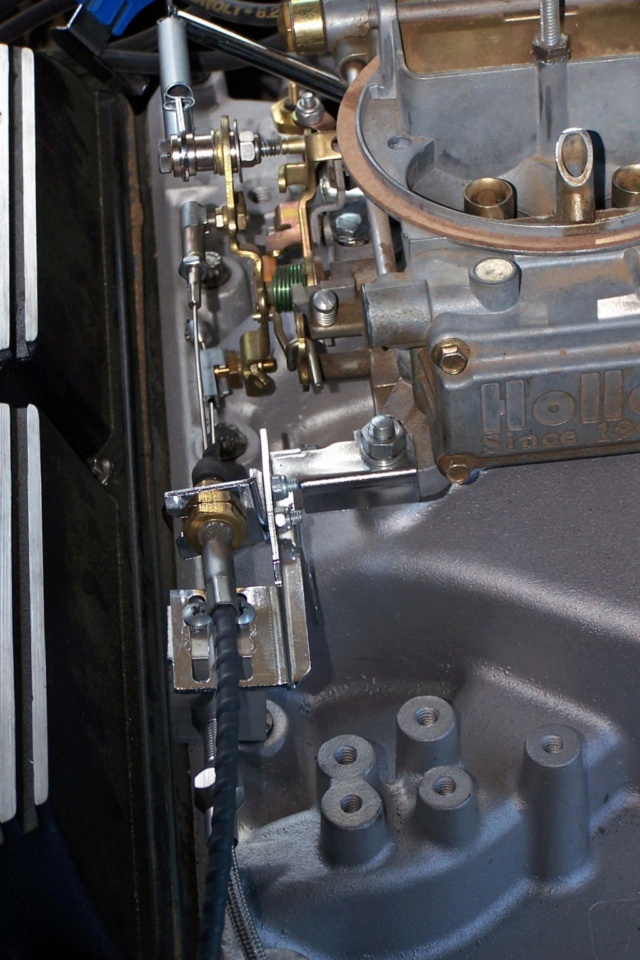

    I have been selling my 240 cables AND THE V8 cables for many years. I DESIGNED MY V8 CABLE to be longer and use a special end for the carburetor end mount. Its designed so that it can cleanly come down to the back of the carb from the back of the doghouse and so it has to be a longer length as well to do that. The BEST routing IMO as a very suttle bend rather than twisting and turning and so on. Its straight forward, however the cable WILL WORK DOWN TO A 6" RADIUS. I route it down the drivers side along with the wiring and the fuel line. VERY KLEEN,,,,,  I tried the LOKAR carb mount and returned it as I found the universal one for about $9 bucks offers much better kick down adjustment
    67 throttle cable in a 61 epup with 302 Oskool15
    67 throttle cable in a 61 epup with 302 Oskool16
    67 throttle cable in a 61 epup with 302 Oskool17
    as well as carb adjustments.

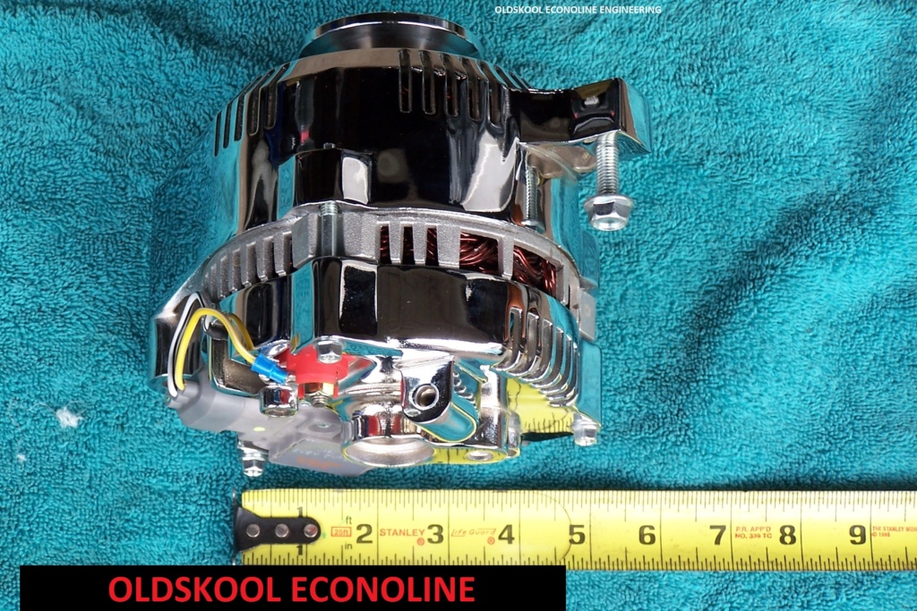

    Its looking nice,,,,,  a couple of red flags to me though?  I dont want to be a know it all and or pick on anything,,, Just a few things that I have talked about for a long time and perhaps some new info for you to consider?
     The alternator pushing my buttons at first,,,,, In those days that unit would have been okay, but it does exactly nothing when its idling as it can only put out amps beginning around 1500 rpm to excite it and keep it putting out juice. Higher rpm needed to keep higher amperage output at its peak. I am a BIG FAN of NO MECHANICAL FAN as well as using a PULLER fan as you have. For years I have been saying that you can set an electric fan to CONTINUE to work after you shut the motor off. IMO A BIG ADVANTAGE for our Barbecue dog house setup. Added value is that an electric fan setup uses less hrspwr as well,, maybe not much but still............
     HOWEVER there is a problem here as I see it and the reason why I found and use the 3G alternator as the infamous  100 amp GM bad boy one wire is now a dinosaur as well.
     Many years ago when I found the 3G alternator it was while researching tech info and found that a SINGLE BELT has a MAXIMUM AMP rating of 80 amps. The GM unit comes with a SINGLE belt and so the info contradicts each other, except for a one big point,,, The GM unit not putting out any amps at idle but rather the 100 amp capability at over 1,000 rpm. This is why it wont squeeeeeeeel at idle. It has no load on it until the rpm is up.
     This brings up the my main point, and its not picking on you, but perhaps you werent also aware of all of this as well as other new people not aware either,,
     SO,, A FAN CFM number directly depends on the amount of amps it uses and if less amps to it then the less the rpm will be which means its not running at its fullest cfm rating.   All of the hoopalah about the ONE WIRE stuff is also antique according to the other research I did.  You can easily change any alternator to a one wire by simply by passing the yellow sensor wire to directly to the battery connector,,, The one wire was designed for an alternator that was a long distance away from the AMP LOAD, which on ours is at the battery terminal of the starter relay... waste of time IMO,,, Super easy on the 3G as in the picture.
      The 3G alternators has a lot of advantages as it puts out 90 amps @ 600 rpm.  Coming in at least three sizes that I know of. I use the 135 amp unit as its far more than we need and works perfectly if a few things are taken care of. This means that when you are stuck in stop and go traffic and its so hot you can fry an egg on the roof of ours.......THAT you can sit there in gear, at idle, and the fan and your cooling fan will be working at its FULL CFM.  The ONLY ISSUE is that IT WILL SQUEEEEEEEL at idle as it needs TWO BELTS. Remembering that a single belt will only handle 80 amps and the reason why. I prefer to also use the short nosed water pump at the same time as it gives me another 4 inchs or so room to play around with....  Just sayin,, not pickin,,,, only trying to help.... The last picture showing the PIGGY BACK regulator (very nice access, and no more in front of the radiator) and shows how to convert it to a ONE WIRE alternator. The yellow regulator wire is the sensor wire and reads the amp load at the source of which,,,,,,,,,is at the battery terminal of the starter relay.  Next pc showing a custom mount I made up to install one on a customers 200. Issue was he didnt want to go to the DUAL belt at the time and eventually got tired of the PREDICTED squeel at idle. Ended up putting the dual belt setup on it after all..... 1 st picture is from Brian Everwain who finished figuring out the serp setup for me. Also clearly showing why I use the short nosed water pump.... IN THE OLD DAYS you could get a "MATCHED SET" of belts,,,,, NOT any more, as the basic reason of why the SERPENTINE belt is used....67 throttle cable in a 61 epup with 302 Lt_sid1067 throttle cable in a 61 epup with 302 2791067 throttle cable in a 61 epup with 302 100_1112
