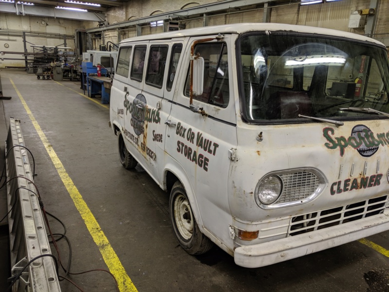

    Greetings from Indianapolis USA. I picked up this Econoline after a long search about 3 weeks ago. So far I've done the brakes and am working on getting the engine running. It's got the 240c.i. and the 9" rear end, and it has passenger doors on both sides, which I had never seen before. The frame is remarkably solid for being an Indiana vehicle, but the front pans are pretty much gone. I bought some new ones but haven't installed them yet.
    Now, the paint is interesting. They even painted the roof, I guess so people from the 2nd story of office buildings could see them as they made deliveries. I'm going to save it for now. The body has some rough spots, some bad bondo and repair jobs, etc., but I think I can get it presentable and functional without destroying the paint. I'll shoot clear over it for the time being.
    Honestly, I would like to paint the whole van someday, so we'll see what happens. First order of business will be getting it driveable.
    Let me know what y'all think.

    I do the Econo postings on this site and saw that Beauty and fell in Love with it! Congrats on the Major score!!! cheers cheers cheers
    I would keep that Paint for as long as I could because it's showing it's age in spectacular fashion and it's only going to look that way once...Keep in mind that this is only my humble opinion and you should do whatever makes you happy!
    That's a Fine piece of History!
    I reimported your pics at 640 Pixels so they wouldn't get cutoff...

    Make that 2 votes for keeping the original paint! JM2C

    Looking good, that's 2 for keeping the original paint so far!
