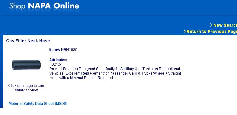

I have just replaced mine a week ago. I found it at NAPA (Hose 607) for $12 foot as well but they waived the tax.. (For farm use Twisted Evil ) so got it for $9ish but just glad they had it!!! Even if they said it was $20, I needed it and wasn't leaving without it. It was the fourth place I looked and I wasn't picky...

That 607 sure looks like a radiator hose,,,,,
