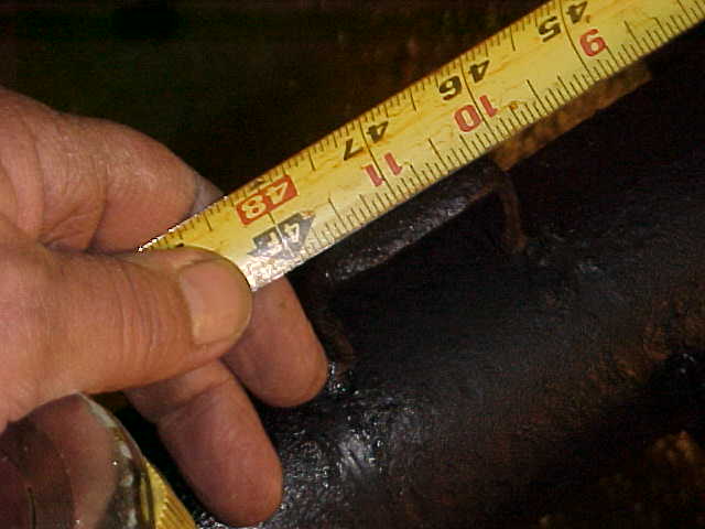

    Post by Digz Tue Apr 14, 2009 5:29 pm
    Okay heres what I got for measurements , 15 inches from housing to perch and about 47 inches center to center on the spring perches, the distance across the differential housing is slightly less than 16 and 1/4 inches, add 'em all together ya got almost 47 inches. And that 47" was also my center measurment on my front spring hangers.
    Digz's 65 panel - Page 5 15_inc10
    Digz's 65 panel - Page 5 47_inc10

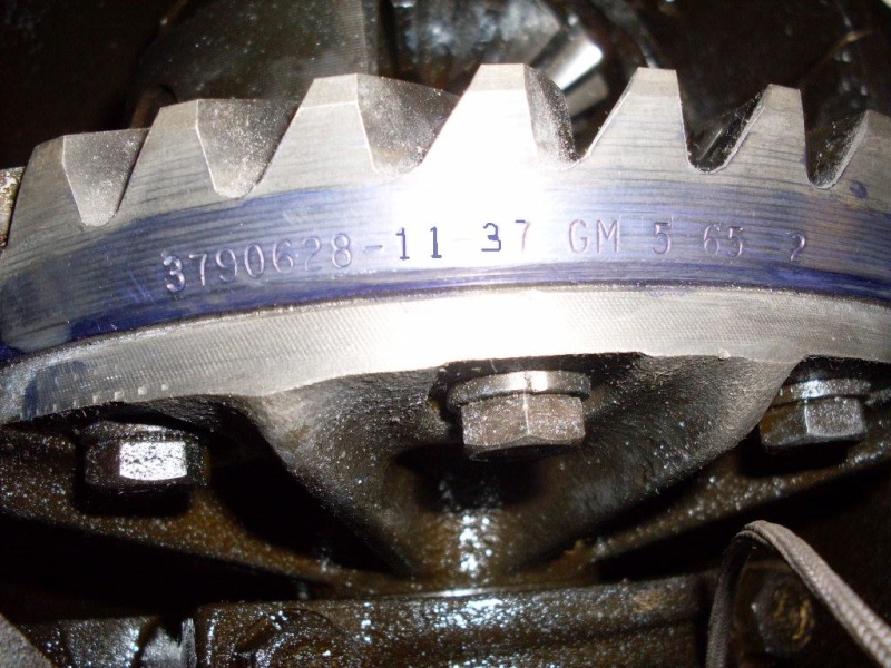

    HO 12 11 W
    Digz's 65 panel - Page 5 Ho_12_10
    9-37 11 64 GM 1
    Digz's 65 panel - Page 5 9-37_110
    I didnt have my camera with me when i did the pinion, but the spacer was shorter and had the bulge in the center compared to your pic Don.
    Kinda gettin the idea they used alot of different designs over a few years.

    Mine is HO 12 11 W , This is an 8 and 7/8 ring gear to, that may make a difference. I couldn't find anything on line that makes sense of the numbers, except that maybe the "W" might mean it was made in Warren MI. The spacer in my pinion didnt go from bearing to bearing either , it bottomed out ona shoulder on the pinion shaft. has to be a difference in being a HD 12 bolt or something compared to the 10's.
