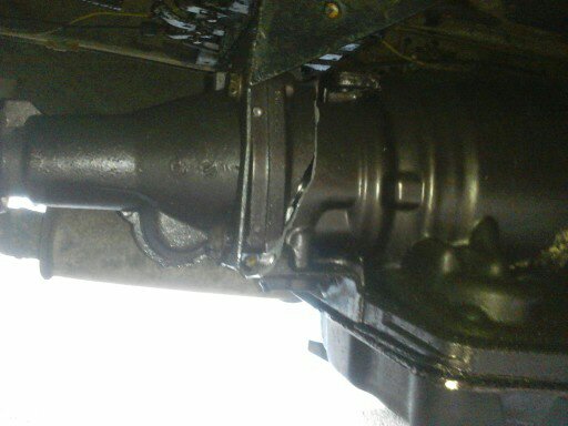

  I have always preferred fabbing a bracket and hanging the trans too, but gave in and ordered a crossmember and made brackets to install yesterday. with a stock engine, highway gears and cast iron tranny, I would keep the hanger but double the h.p. triple the torque and lower the gears and it swings around a bit. to make matters worse, I lowered the engine/trans an inch for the 292 to fit. this is what could happen. after that, I choose to loop around the tranny and bolt a mount on the factory location but that just amplified the swinging.  4 barrel on a 292 straight six. Done it?  - Page 2 14400510

Do you believe the cracked transmission case shown is due to the type of transmission mount used?  I have seen that type of failure before when a too long driveline was installed.  The suspension shortens the distance between the rear axle and engine/trans on big bumps causing the driveline to be forced into the back of the trans.  The back of the trans looks solidly mounted so the force could be transferred to the spot just forward of that.  The motor mounts would have some flex to them but could get torn when this happens.  When you lowered the engine and transmission by an inch, did you shorten the driveline?

I believe this was from a failed u-joint. part of the rear u-joint was still there but the driveshaft and yoke are still in indy. I had left 1" travel on the yoke and had an original rubber mount at the top with the single bolt threw the center so with the exception of the 1" drop, it was the same as original. I don't blame the hanger, not entirely anyways. this hanger only allowed about 1" swing either way so by limiting the swing, it transferred the force onto the tail housing bolts and the weak point was the very thin wall aluminum. the new hanger was cobbed together mounting on the bottom and a rubber mount installed. swinging became a huge issue and I installed a brace to the frame but constantly broke bolts. while adding 2 heavier braces and more bolts may of worked, it would basically be a crossmember at that point so I just ordered one for 60 bucks and made brackets to weld to frame.4 barrel on a 292 straight six. Done it?  - Page 2 20190510
