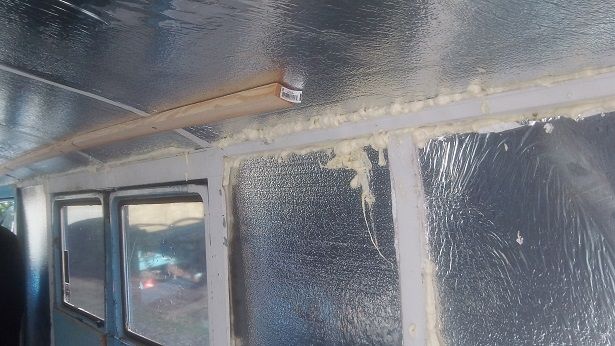

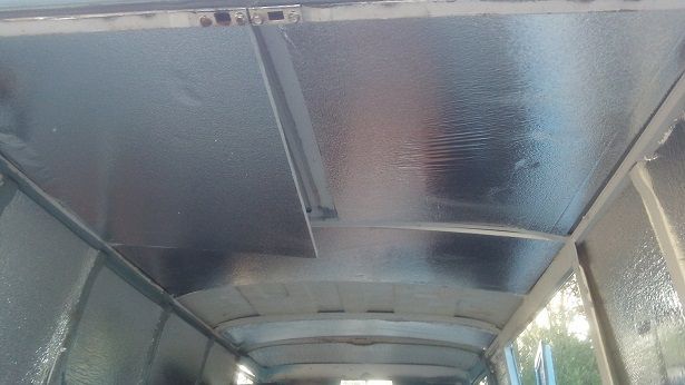

I decided that another winter with no insulation and all the rattling noise was not gonna happen this year. Since the kids are busy with their lives, I do not need the seating in back so I am gonna turn it into a camper so I can go out and about and have a place to hang out - and not have to sleep on the ground!
I had some Reflectix insulation on part of the roof - it fell off after about 4 summers. The paneling on the walls was original and there was nothing behind it.
A completely different interior and feel in less than two days!
I plan on using undercoating to spray the floor and then putting insulboard down along with some version of wooden flooring down. Still unsure about the walls and ceiling though...

Well, I am using 1/2" R-Tech insulboard, 3M Super 77 Multipurpose spray adhesive, Great Stuff gap and crack spray foam, 1 by 2's, 4 by 8 sheets of 1/4" underlayment, Rust-Oleum LeakSeal flexible rubber coating, and #8 by 1"and 1/4 self-drilling lath screws... this is my list of things I am using so far... By putting the 1 by 2's like I am, not only do I have the 1/2"glued against the metal, but I am able to add another layer cross ways and then add the 1/4" underlayment over it all... It looks like it will bend enough... just have to hope I can measure and cut everything close enough to look good... the wood itself looks like I could either stain it or just varathane it and it would look good...

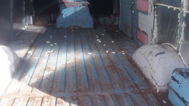

It amazes me how one thing leads to another to another and before you know it, you're sitting in the middle of a field going how did I get here???
When I got to looking, the battery box bottom was further along on rotting away than I thought. I moved it 14 years ago and it was already old then! Thankfully I have a new one to replace it with...
I have to put it all together temporarily, so I can go back to town and get 4 or 5 more cans of undercoating/sealer, and then come home and take it all apart again, to finish it before I start on the woodwork again!!!

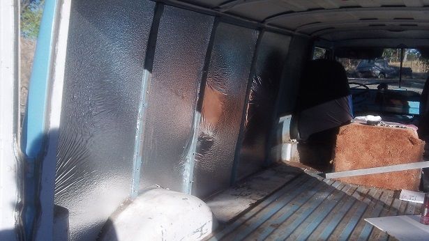

Now I have to wait for it to dry and then I can start putting insulation and wooden furring strips on the floor to get ready for the underlaynment and oak floating flooring I just picked up.

What did you use to quiet the rattle between the roof and the cross beams?

I have been using spray expanding foam and every few inches along it I squirt a batch in a hole so it spreads around in there - seems to work okay. I have more rattles in the doors so far! lol
The flooring is just sitting there so I could measure and look...
from the side doors...

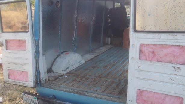

Make sure that there are no screws that penetrate into the gas tank.
It's lookin' good.

The screws I am using are only going about a 1/4" into the metal, so I am pretty sure I haven't punctured the tank! (I hope! LOL)
Most of the floor is cut and ready to be glued and screwed...
Rear doors...
Side doors...
It's raining and miserable out so i have been taking it slow. Not too mention my back is killing me, having to work in such a short space!
