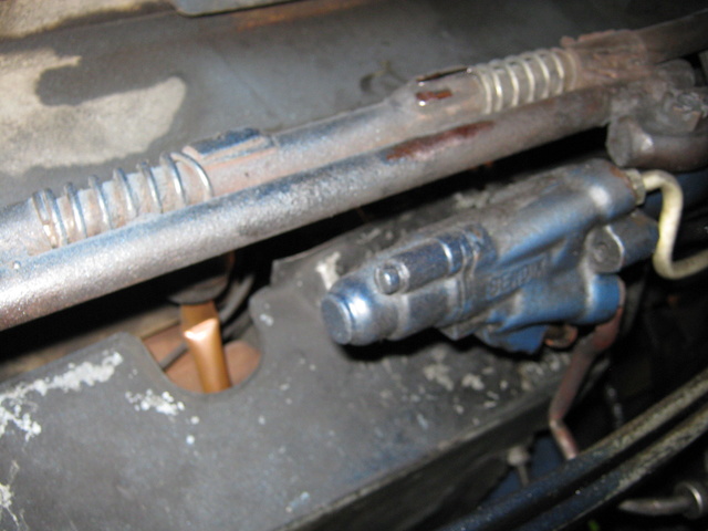

I built that system up on my 65 which has been a daily driver since 2006 still works right and never any leaks. I used the chevy pump cuz it fits on the engine easy, you just have to lighten the presure rellief spring under the large outlet line nut on back of pump. I used 69 cougar PS parts because there all the same.
https://i.servimg.com/u/f97/13/10/37/95/dscn1710.jpg
you can search it on this site. I don't know where all the pictures are but I do remamnber a long thread on the subject.
m1D
