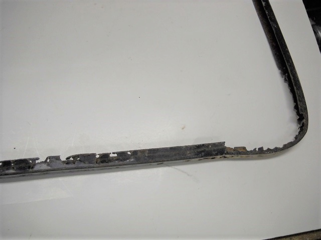

So, I am gonna try a new project... rear windows into swing out for air flow. I have seen it done on the site by a few people. I have never done this type of project. I am not sure of anything... accept I am not sure? what I am doing.
Donivan is giving me some pop out glass to get the thing started,,, I bought frames which I thought were the correct ones, now maybe not? Hmmm here is the beginning of the mess. The glass is out of the frames... now how to make them work? Gonna cut the frames down to size then...TBD next week Laughing

looks like she has got 4th Gen chrome frames that the glass is just glued in without a rubber gasket,,,,,,,and of course,,,,,way too big to fit our 1st and 2nd Gen doors,,,,,so the frame needs to be cut down,,,,,,she has stationary windows,,,,those go IN the door frame,,,,Pop Out windows are bigger and go ON the frame,,,,,,but Pop Out frames are pretty hard to find in good condition, so we use the frame off a 3rd Gen, which are  Swing Out windows, cut it down to fit a Pop Out glass
HOWEVER,,,,,,I see that there is no latch on her  frame and it is mounted by drilling a hole in the glass,,,,,,,it looks like  too much trouble to make 4th Gen frames fit a 1st Gen,,,,,,,,,I guess she can go and try get her glass cut to fit after I drop off a sample Pop Out frame for her to copy,,,,,But if there are no hinges on her frame,,,,,it is,,,,,,,,,,,USELESS
