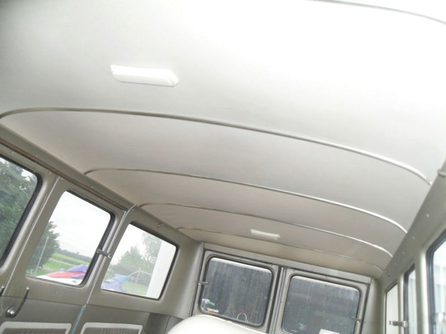

Sunday my wife and I drove the Van around quite a bit, had a good day. Later after we had been home for awhile I noticed he headliner had come loose at 2 places in the middle?
Bummer! I don't want to take the whole roof and sides apart to do it all over. I think I should have used thicker wood strips and longer staples????
Anyway I have a couple of pictures of a original roof that has the chrome strips at the seams.
I was kinda thinking about doing this at first but I liked the way it came out without the strips. (until it came loose)
Anyway I made some strips out of 1" aluminum and bent them slightly after stapling the headliner back up and set them over the seams to hide the staples and support the seams.
Right now it's just a tight fit but I may ad screws to hold them in tight. I might even cover them with the black material to match the sides and not stand out so much????
This will work for now.
- Number of posts : 9607
- Post n°97
Re: Russell's '66 Sportvan Deluxe
Looks Great and is functional! I think it's a nice finishing touch on the headliner!
