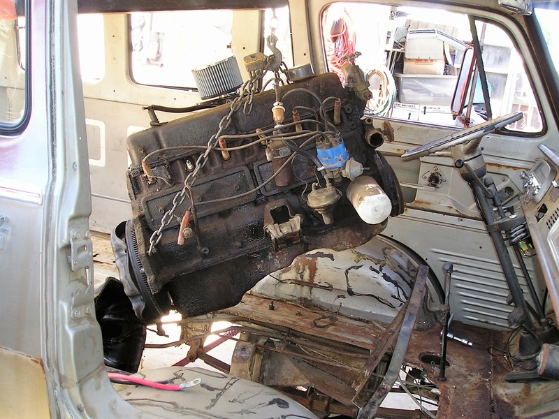

Saturday I cut the doghouse away from the floor, removed linkage, wiring etc. and yesterday I removed the 230. I need to do some cleaning and trim the sides before putting the new engine in.

Well, that makes it easy to remove the old straight 6! Nice progress. Now is the perfect time to unbolt that crossmember and get it all cleaned up.

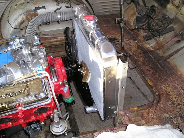

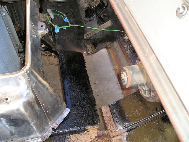

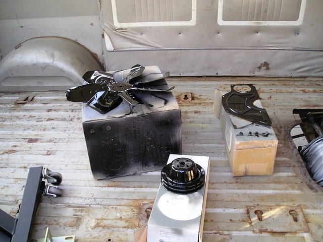

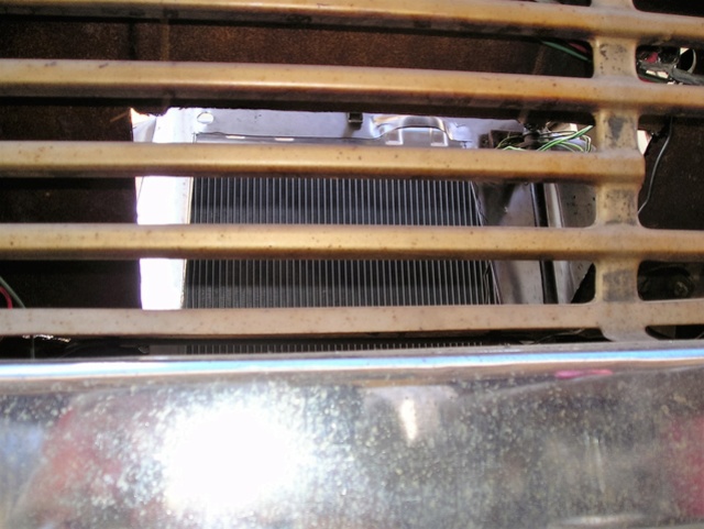

I got a few things done, engine is in, trans is hooked up with new clutch plate,
I also put the radiator in. I tried using the original radiator support,(after an hour of cleaning it) but I didn't like where the radiator fit with it.
I ended up cutting and drilling some 2" x 1" aluminum angle iron for the sides using the mounting holes for the stock support, they fit nicely with the radiator much closer to the fan. It also fits under the new doghouse well.
I have spent more time cleaning parts than putting this thing together.
It took 50 years to get it this dirty, it's gonna take a while to get most of it clean.

The previous owner had moved the parking brake, I guess to install the gauges.
A lot of work went into that modification.
I was able to replace it to the front of the doghouse.

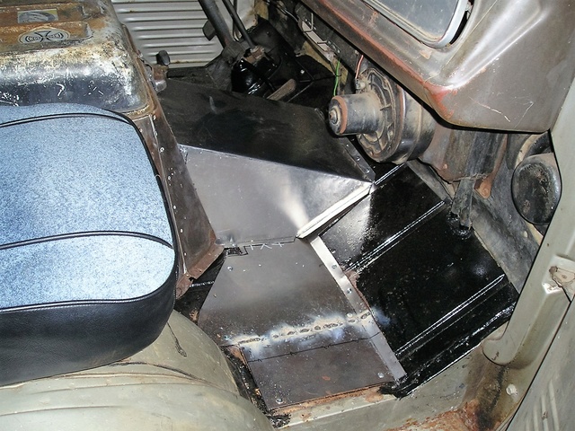

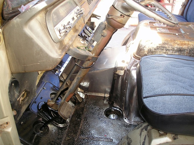

I'm getting so close to being able to drive it, it's just that "one more thing to do" has been going on for days, I re-routed the wiring and eliminated the plug in the engine compartment, ran new wires to the starter and regulator and alternator, relocated the horn relay and added more wiring. I also cut a hole in the floor to ad a tunnel for the radiator, also cut the front out of the doghouse after stripping a couple of coats of bad paint.

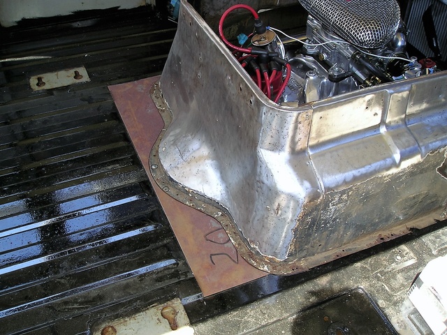

I'm also making a rear section to fill the hole's caused by the different shape of the later style doghouse.
I made a cardboard template and then bent some aluminum for the tunnel.
I don't have a brake so I have to make all the bends with a hammer, vice and some angle iron. not exactly easy.
I also made a new battery box which will mount under the passenger side since mine used to be inside the Van behind the seat.
It still needs the exhaust and more tweaking on the doghouse etc.
I am also going to put in a door for checking the dipstick. (oil level)

I finished a few things and now have the doghouse in place, the tunnel is mounted, seats are mounted and I cut a piece of sheet metal for the rear of the doghouse to sit on.
I need to take more pictures.

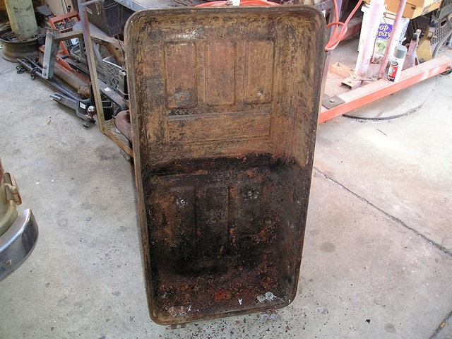

Vanagain gave me a step assembly just missing the step itself, it is really rusty! I might be able to clean it up and or fabricate a few parts for it to work.

More pictures of where I'm at now.
I have the doghouse, tunnel and floor pieces sitting where I want them, I had to re-do the drivers front seat mounts yesterday, it has no track and I wanted it closer.(more holes to fill)
Now I get to take it all apart again so I can weld the floor, holes in the doghouse, add insulation and cover everything. WOO HOO!!!!

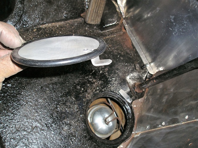

I've been able to drive it around some and tweak a couple of things, today I mounted a prop for the engine lid and made a cover for the master cyl. floor hole.
I know these are hard to find so I made one using aluminum and some pop rivets.
I found a roll of tape the right size of the hole, I traced the circle onto some aluminum and cut out the circle with a jigsaw and cut a couple rectangle pieces for the tabs.
I bent a tab, drilled and pop riveted it to the cover plate and put some "door edging" plastic around the edge.
Then set it in the hole and used a self tapping screw to hold the other tab to the floor,
I think it came out nice and will keep the air out while driving with easy access.

Excellent work, Russell! I was trying to think of how to make one myself when I change over to a dual master cylinder. Nice simple design and looks like it will do the trick nicely...Thanks for the ideas!!!

I dropped in on Russ yesterday. His master cylinder cover is a nice, simple design. I have a stock cover but the rubber on it is so hard, I'm afraid if I ever pop it in there, I never get it back out.
Vanny, were you thinking you have to enlarge that opening? I did the swap to a 2nd Gen master cylinder. I still can access it through the round hole. it's a little tight but I think I'll leave it as is.
