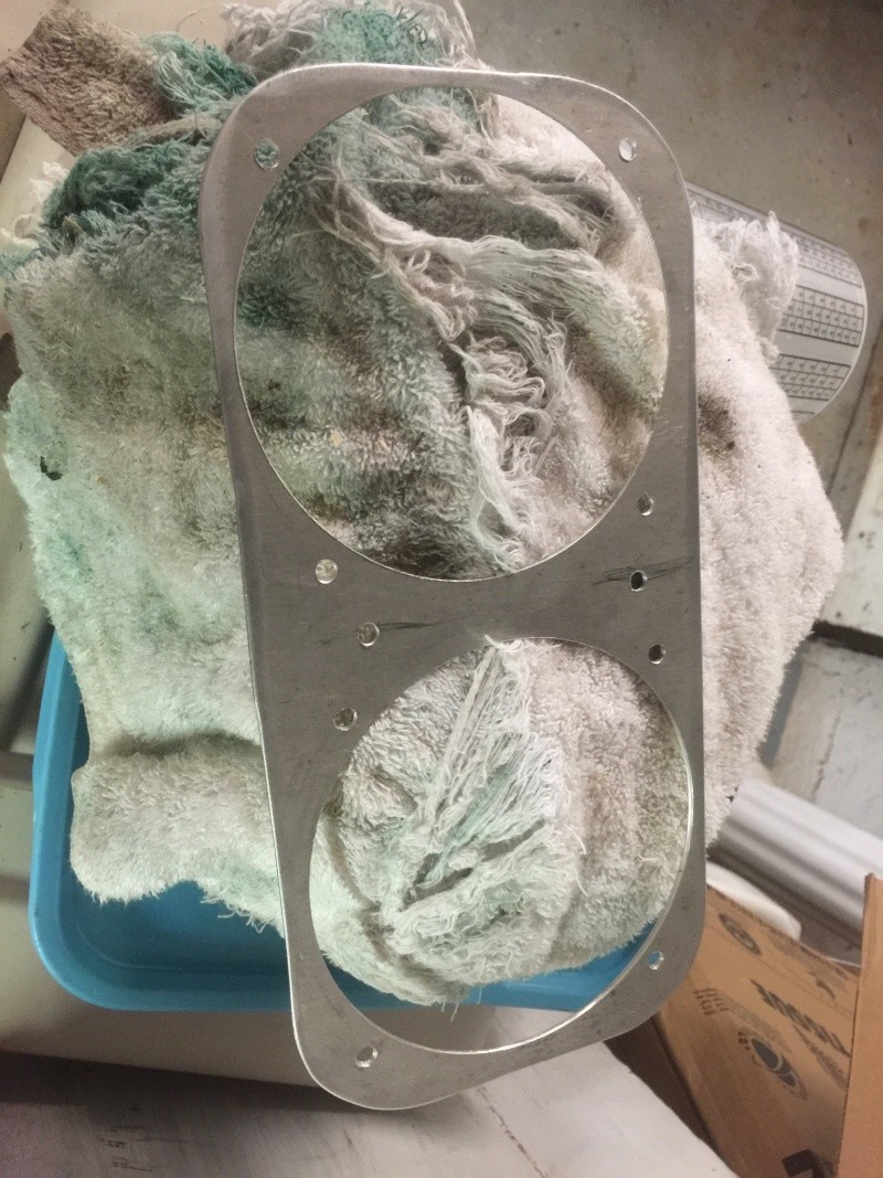

I made up a bracket to mount 2 5-1/4" speakers the the existing opening. It's a little crude but easily replaced and zero dash modification.

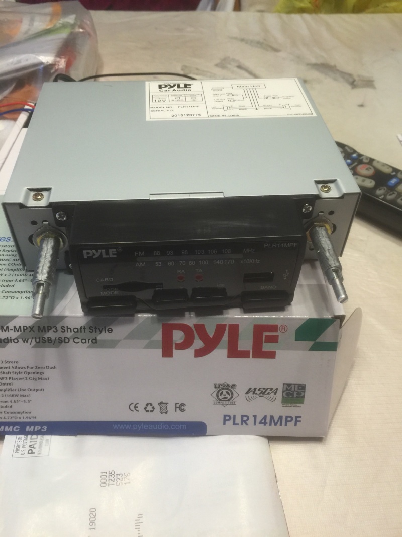

This is an experiment. I made 2 delrin spacers on my lathe as a cushion so it would give a backing to the machine screws. It's just a plate of aluminum with wrinkle powder coating. It wasn't rocket science. I ordered a cheapie Pyle Dual shaft radio for it. I had ok luck with their stuff in the past. It's easy enough to yank out. and once the harness is made up for the Van its going to be plug and play like a stock late 70s early 80s GM with the 3 plugs (Minus the one for the rear speakers I don't have.

My radio came in early so I wired it up when I got home from work. Even moving the shafts all the way out I had to kind of wiggle it into the opening. You'll see in the pictures.

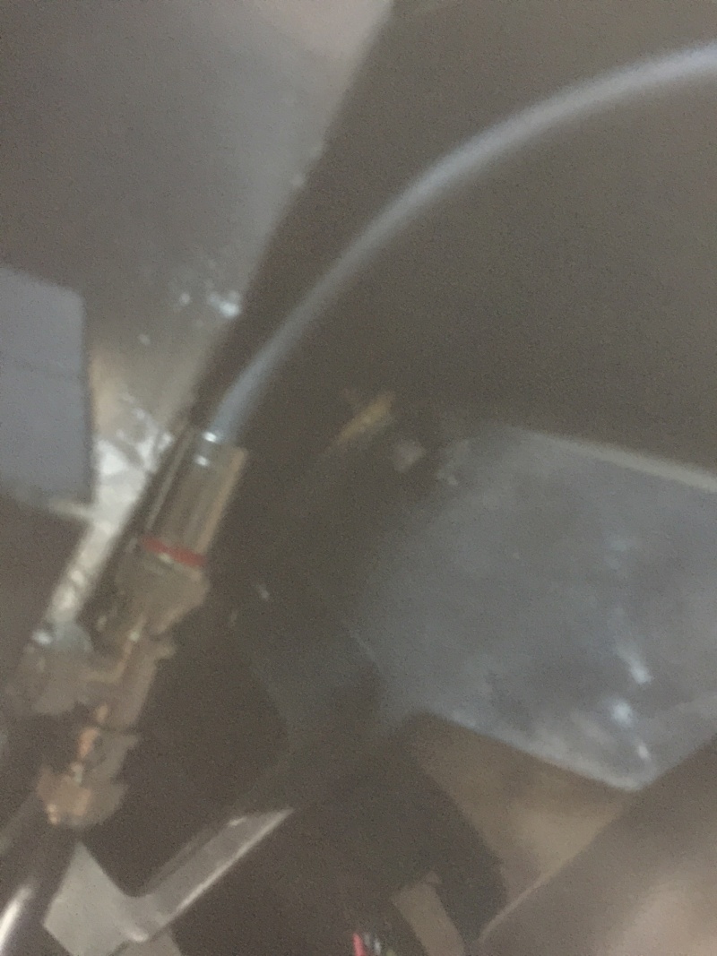

Then the Bezel no longer fit so I made a new one out of Diamond plate aluminum, Machined up some spacers out of Delrin plastic to hide the shafts and I have a radio. With the antenna adapter I got to go from BNC to the Car radio. This cost me about $35. I'm using the CB antenna I have the scanner hooked to, and my radio reception is perfect. Most of the wiring metal, plastic is stuff I have laying around. and the speakers I bought an eon ago from the junk yard so they couldn't have cost more than $5 each. Like $3 worth of machine screws and nuts.
This Cheap Pyle Twin Shaft Radio isn't bad for $20. Shame it didn't fit better, but I made it work. Their bezel was still too short and you would have seen the dimples from the shaft openings. This looks a little cleaner IMHO. For a quick install on the fly it came out alright. Now I have tunes. It was starting to drive me crazy..

Tucked the wiring up in the dash and tied it off. I have the radio power tapped right off the fuse panel. You'll see in the next set of photos.
