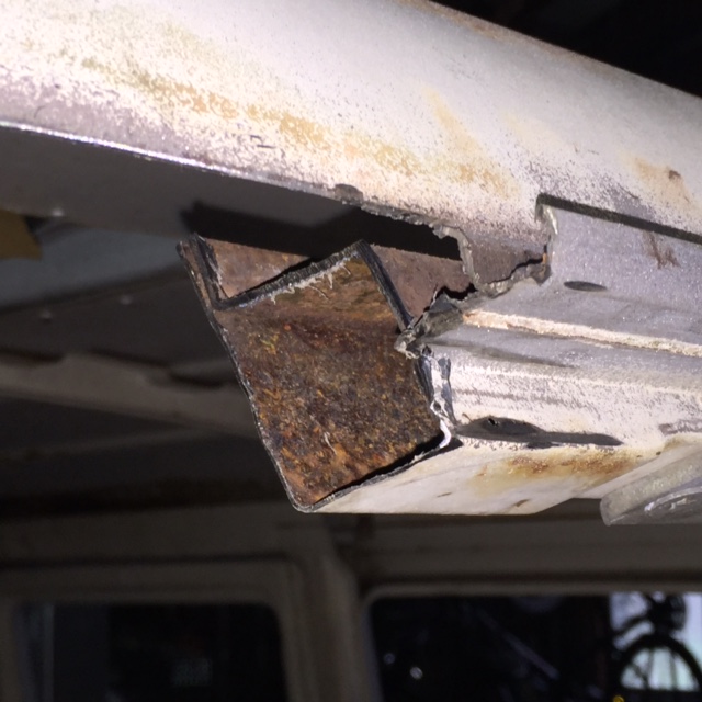

Here is some crusty gunk under that rear drip rail, and next after I cut it out

Tried to think how to replicate the structure portion.  Just couldn't make the shape the same but I came up with a different plan that will probably work ok.  Made a bunch of small 1" wide sections while figuring out the shapes.  I'll use them as a template for some beefier sheet metal ones that are full width of the repair.

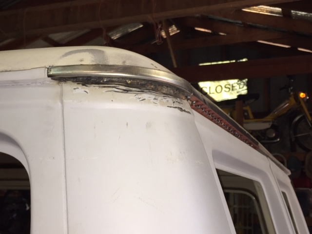

Thanks guys.  Got it roughed into position.  Still needs lots more welding, grinding and sealing.

I believe you got it figured out. That looks damn good. cheers cheers cheers

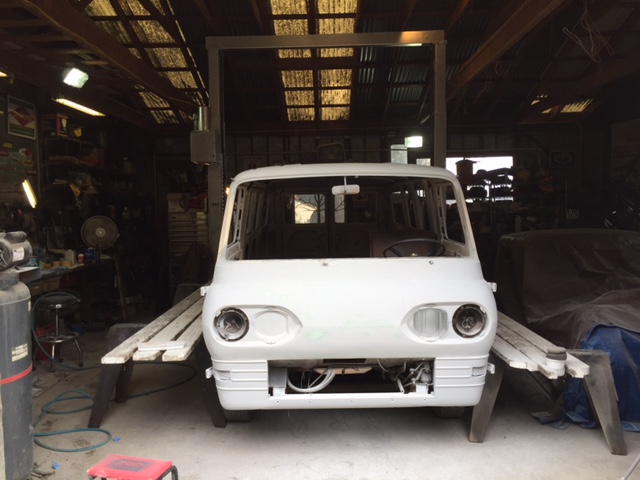

Been putting a ton of hours into the van but not much that seems note worthy.  Just block sanding like crazy and filling low spots that had been missed.  I filled in the vent that someone had added and sandblasted all the rust off the roof.  The whole exterior is in primer and almost ready for paint.  Interior still hasn't  been touched.

Had to set up some scaffolding since there was days worth of roof work

Nice setup, work smarter, not harder!

Man, If I had a barn like that I'd have that 8 Door Van I've been itching to buy sitting in it! lol
Nice work filling in that vent hole! Can't wait to see it Painted! Pick a color yet?
