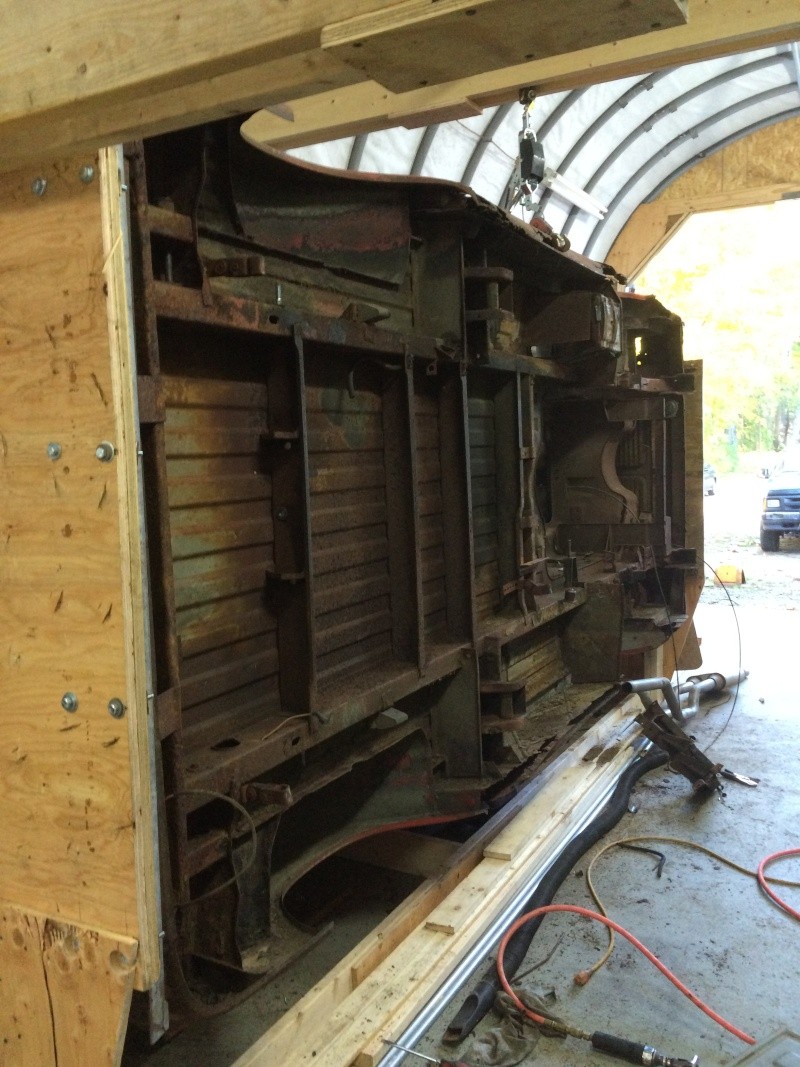

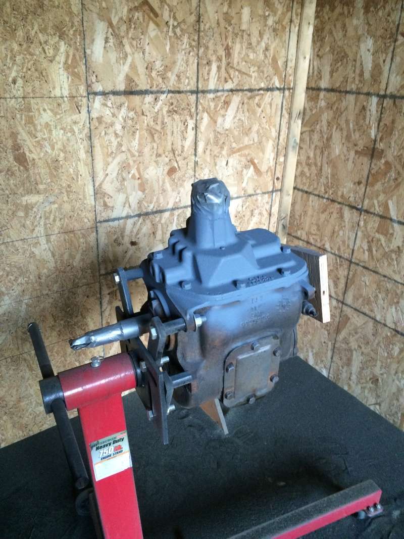

After over a year waiting for a guy to get me 2 rear springs for my 67 I think I may see them in a week or so but since I'm recuperating after prostate surgery and my son is home for the day I thought I would get some pics up to see my progress. The front axle has new brass bushings and is back in the van I found a M420 Muncie4 speed so I will have my rat fink shifter after all.I needed a whole side to make my baby a no door I was willing to go anywhere this side of the Mississippi to get it and pan58head had one in NH awesome guy to deal with. I guess i'll put up some pics.As I mentioned I'm turning my van into a no door If any body has done this I could use all the advice I can get. To hard to caption all the pics so the only ones I haven't talked about are the ones of the tramway I had to build to roll the van out of the shed to have it sandblasted.I than painted the bottom with self etching primer and POR 15 topcoat

Major progress. Did you uses to work for raii road?? Nice set up

OK! I have to give extra points on this one purly for the inovative force and will power to get the job done with availible resourses.
great work! The van is coming along nicely.

nice work on the home made body roller

looks good man! never seen a woodin rotisery before ,looks like it worked well!
