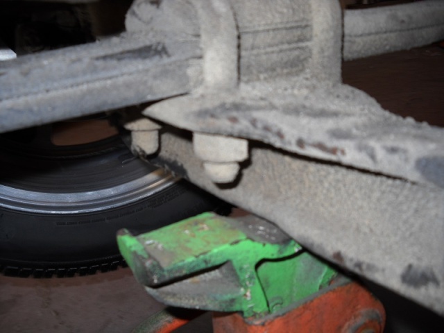

Thanks guys but I need to know the direction of the block on top of the front spring that has a saddle at each end to recieve the "u" bolts. That block is not shaped symetrically. one end has a square shape and the other end is shaped like the front of a snow ski. I have no idea why but the engineer that desighned that block made the two ends different or if it would ultimately make a differance but I am a believer that it was done for a reason.

Post by mo_1040 on Wed Aug 12, 2015 4:44 pm
On my 67, the small end goes toward the rear....

Post by donivan65 on Wed Aug 12, 2015 4:47 pm
I just took these pictures on a 2nd Gen,,,,,,is yours like this,,,,,or you got some kind of foreign parts on that van,,,,,,

I still am not sure on what we are talking about,,,,,,,the cap on top of the spring or the shim under the spring,,,,,

Post by donivan65 on Wed Aug 12, 2015 5:18 pm
if we are talking about this cap,,,,,,MO,,,,,take over,,,,,

Post by dougtappan on Wed Aug 12, 2015 6:21 pm
Donnie, thank you for the great pic of the block I've been trying to explain. And MO a million thanks for the pic of the block on the spring. Now I think I can be confident that the small side (if you will) goes toward the back of the spring. Thanks guys ....... great info.
