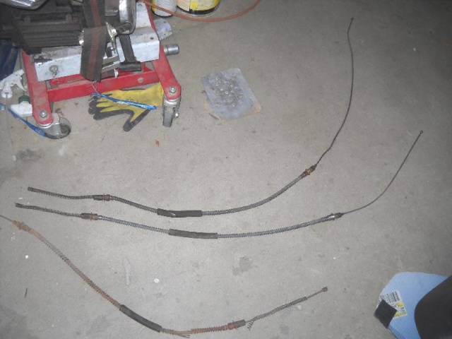

well Ed,,,my EIS book says all the 2nd Gens use the same parking brake cables,,,,there are lefts and rights,,,,,and if you want to send someone a PM,,,,,(Private Message), click on the orange arrow next to the persons name....

Post by donivan65 on Tue Mar 10, 2015 12:30 pm

Thats strange that a 68 would use the same length cable because unlike the "E" vans the wheel base is longer on the 108's. I will be in the market for a pair of cables also ......But I did see a post here of a company that will custom build the cables for us. Let me do some digging.

A 108 surely needs 18" more cable somewhere,,,,,,either the front, 2 rears or maybe some intermediate cable,,,,,,,,I don't know if you can believe all these different part numbers,,,,,let me see if I can measure a 1st Gen so we have something to compare the others to......

OK,,,these are 1st Gen 90wb cables,,,,probably the same as a 2nd Gen,,,,,the left housing is 24 7/8" long with a 51 1/2" long cable in it,,,right side housing is 23 3/4" with a longer 59' cable in it,,,,,I have a broken cable that the spring that holds the cable to the park brake arm can come off the cable if you roll it off,,,,you can have it if thats all you need,,,,
