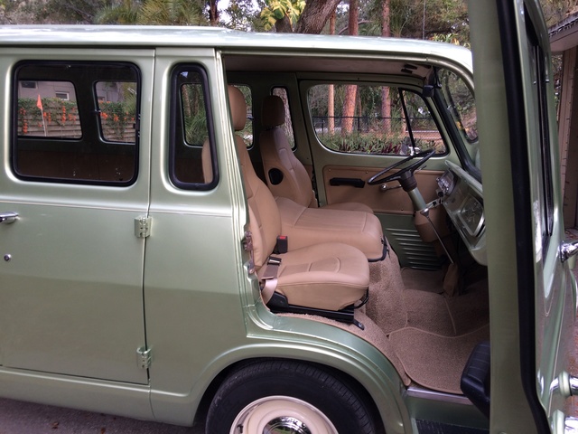

Well, I was hoping to "unveil" my van as a fully completed project but I don't know if there even is such a thing. It's almost there but there's still some bugs to work out and a few more things I want to do. I'l probably post some questions in the between the seats section later but for now, here's what it looks like.
Still to happen is A.C., stereo, steering wheel, a back seat and a few fixes.

Looks great! Nice work, Sam.
back2thewoods- Number of posts : 842
Location : easton ct
Registration date : 2008-05-26
- Post n°97
Re: Samvans '66 handibus
looks fantastic!! great job
wideload- Moderator 1st Class
- Number of posts : 1388
- Post n°98
WOW !!!!! Looks great Sam !!!!

She looks Beautiful, Sam!!! Love the interior panels! Nice paint choice too!
