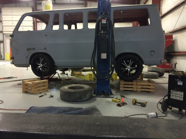

Getting my front end lowered a little. The guys moved the leaf spring perches up and got everything tacked in place. Nothing drastic but I think it's going to look good. We did end up flipping the leaf springs on the rear end. That lowered it a good five inches so we're going to have to add leafs or air bags to bring it up a little. I want a little bit of rake when it's done.
Here's some pic's of the progress.

Once everything's buttoned up with the suspension, I'll try to get some better pic's of what all we did. For the most part, here's what it's going to sit like with my new wheels and tires. I got 8x18 wheels all around (4 1/2" backspace) and for tires, 245/45r18's on the front and 255/45r18's on the back. I think they're staggered pretty good and I got the rake I was after. Check it out...

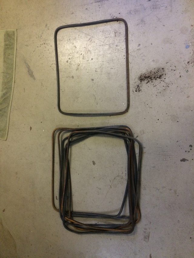

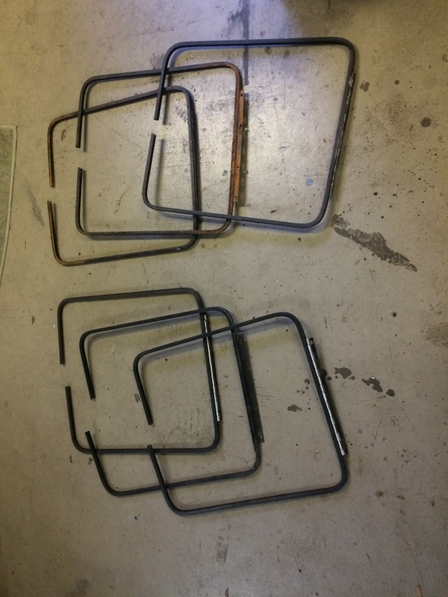

I decided to restore my pop-out windows today. I started with six frames - four from my van and a couple of extras I picked up. I should be able to get four good ones in the end. All the clips are good and I'll try to chrome them all so I'll have a couple of extras to get rid of when they're done. Two of the frames are rusted on the bottom but possibly salvageable. The rubber is actually a one piece gasket and I'll have three extras of those.
I was able to unscrew nine out of twenty four of the screws that hold the frames to the clips. For a microscopic fifty year old screw, I thought that was pretty good. I drilled the rest out to remove the frames. The clips with the frozen screw ends are soaking in PB Blaster until I try to extract them.

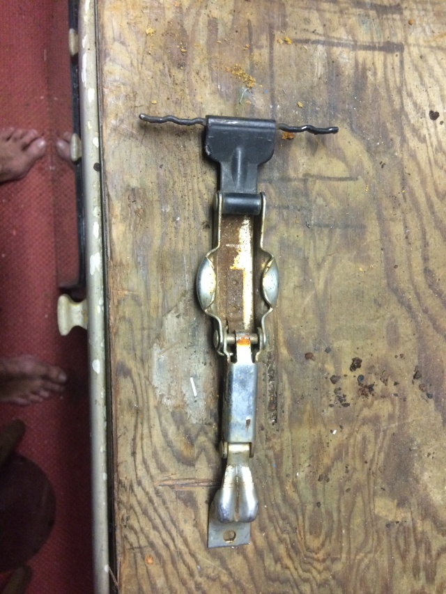

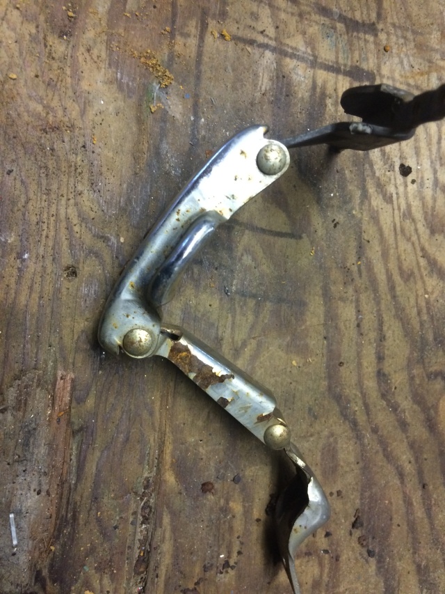

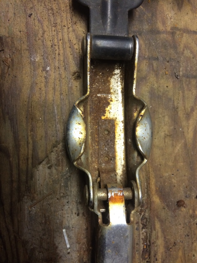

Before I do something stupid, the clips have a few rivets holding all the pieces together. I have to disassemble them to chrome them so I'm wondering if I or someone else can re-rivet these things with the proper rivets. They're definitely not aluminum, they're chromed steel. If it's too much of a PITA, I'll just paint the clips.
Here's some pics of what I'm talking about. Thanks for any advice.
