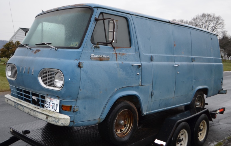

Hey guys! I had my first Econoline delivered from Texas on Saturday 01/03/15. Its a 1967 8-door Super Van. I'm super excited to get to work and get her back on the road. The seller had purchased the van back in the 1980's from a man who said it was a government vehicle but I have not been able to confirm this. He had her on the road until 1993 and then was parked due to a rear wheel issue. So after 20+ years of sitting, he decided to put her up for sale due to a medical issue. He said he used to start the van every few weeks up until 3-4 years ago when he bent the key and damaged the ignition. He stated to me the only issue was the rear wheel locking up and the ignition being in need of replacement. Except for the surface rust where lettering had been removed, he also said it was RUST and ROT FREE! This was the reason I was willing to pay what I did and pay the shipping fees.
Upon the shippers arrival I noticed a few things immediately the seller neglected to mention. Both rear tires were flat and the interior of the van smelled musty and appeared wet. This appeared due to the top of the windshield leaking. Also there was damage to the rear door area which prevented me from opening the doors and other somewhat minor body damage which was not disclosed or seen in the photos. Upon inspection of the ignition I found a rat nest of disconnected wires. Since the weather in the Northeast Saturday was cold and snowy I decided to start the clean out Sunday. When I say clean out i'm not kidding as the seller left the nasty shag and a small dumpster load of trash inside. As my buddy and I removed the shag on the floor we noticed it was wet. Well.. So much for a rust and rot free van. The front floor was rusty and there was some rot in front of the passenger side seat. There was also a rot hole in front of the rear passenger side wheel well. Then to make matters worse we made our way to the back of the van where we found much of the rear floor to be completely rot through! Needless to say I'm not a happy camper. I feel very mislead as again the only reason I made the deal I did was because I wanted a rust and rot free vehicle which is very hard to find in the Northeast. Otherwise the van body is very solid and the underside appears good.
Sorry for the rant, just a bit disappointed with the rot and damage I found. Anyways.. Here are a few photos. You can also see many more photos and follow the progress at www.FordEconoline.com.
If you have any parts you notice the van is missing or ones which may be in need of replacement please let me know as I would possibly be interested in purchasing!

Welcome,
If you can post all the info from the data tag on the door I can get a decode for you. You can also look under the black wire harness cover on the passenger toe board for the body build tag.
Looks like this one from my 67 8 door. Some had them, some didn't. I don't believe your van is a 67. No backup lights and short windshield squriters say it's a 65-66
Does it have a rectangular master cylinder cover like this one? That's a sure fire way to tell a 67. If it's round it's not a 67.

I just posted that in his other thread with the links to all the pics...lol. I was thinking the same thing. His van has a single master, which should make it 66 or 65 i believe. has trans hump also which is 64 and up???? I think. I'm thinking it's a 66.
