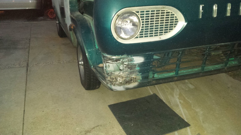

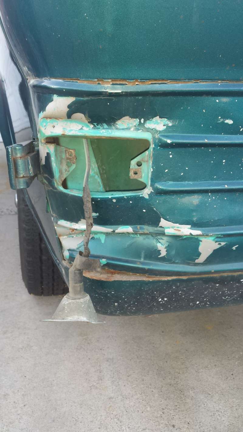

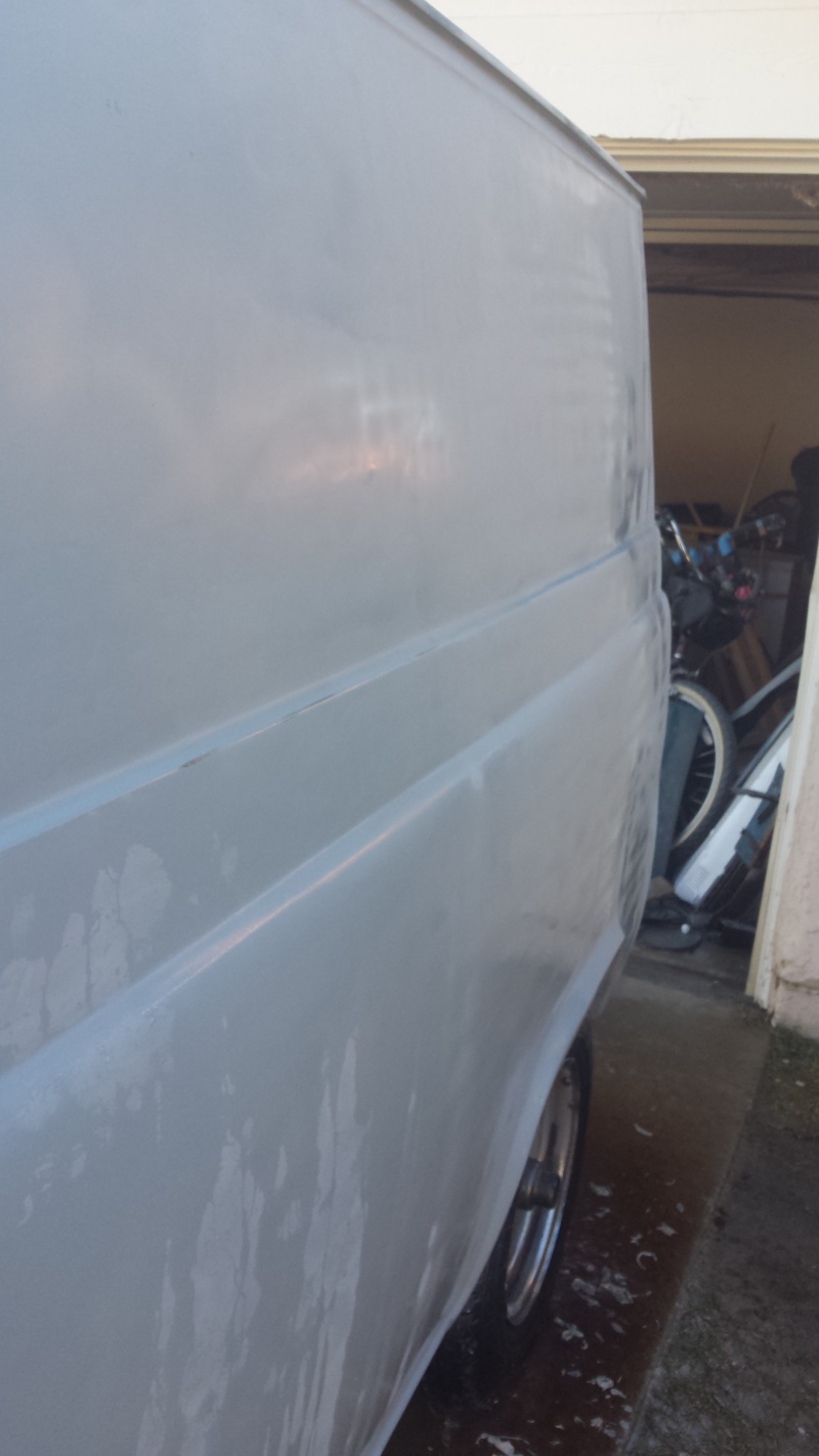

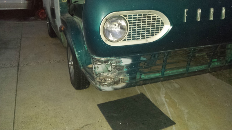

The side is now done still needs a bit of fine sanding and filling, there are a few pin holes and scratches but over all the shaping is done, sanding with 400 now.
The front corner is a pain to get to but its comming back out again here are a few pics how it looked before then after getting under and pounding the metal back out again.
The side after almost four months:
The front corner, when I started this morning:
How its looking now:

So I continued pounding out the front corner, once I got to a point where I couldn't reach or move the metal any more, I cut out that piece and shaped it, then tacked it back in, I was able to reform the curve a bit better with this access also, a bit more straightening and smoothing and it should be close.

Well Vanny its close, there are several little pings and dings, its going to take a couple more months of block sanding to get it all flat and straight enough for paint it looks good in the flat paint but you put some water on it and you really see the waves and ripples, when Im close Ill take everything apart doors windows everything and paint them all separately, I have never painted a vehicle before this might be the first one.

Good effort! For those annoying / hard to see dips and ripples, check out "guide coat' on You Tube.
Easy and effective way to finesse those long flat panels.

Thank you, I have known about using opposing colors to sand with for a long time, but some of the tools he had I haven't seen before and that 17inch block using continuous roll sand paper is sweet, Im picking one up tomorrow and hitting it, thanks!!
That's all for the encouragement, the corner is shaping up nicely Ill post some pics tomorrow.

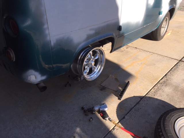

I took some time off doing body work and started thinking about the mechanicals, if you read my engine thread lol you saw how lucky I got, after week of looking for a suitable 200 to replace the tired old 144 I gave up and ordered a remanufactured one, cost almost 2400!1 I posted that and right away someone gave me a line on a engine that was close and it was perfect already had the electronic ignition rebuilt just what I needed.
Now its is time to find the right wheels, went to a few shops online etc. found these sweet 15x7 3.75 bs torque thruster IIs in a close out deal under 150 ea delivered to my door!!
I couldn't be happier the van is comming together and all at a very reasonable price
