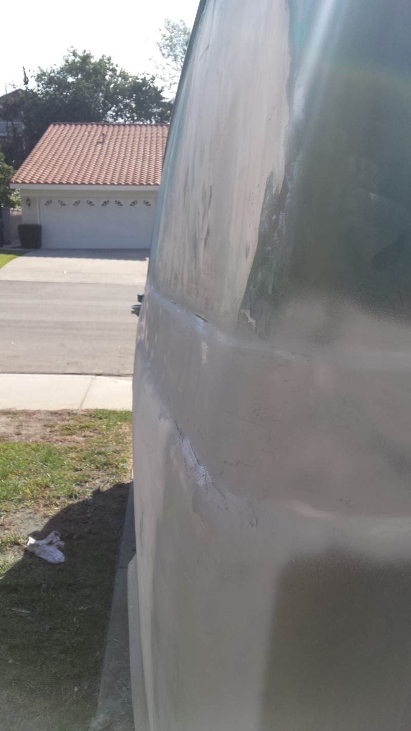

I have completed the smoothing on the side, its very close to the original lines maybe requiring a 1/32 of an inch to even it out, I use the grinder to prep the surface giving the bondo an excellent place to adhere.

I have been working on the side a bit after work each day I get maybe an hour or two a few times a week, the filling is going slowly as always, a thin fill, sand, fill, sand, each time you notice more dimples and waves you didn't see last time, but its getting smooth. Depending on time of day really reveals different depressions and high spots.

I was able to strip the rest of the panel on the drivers side, and primer it around the repair, its still not complete but just about where I want it, mostly just sanding now I did add a bit to middle area to even out a small depression.
I do appreciate all the feedback its been encouraging, there are lots of times when this gets tough and its easy to walk away, but I keep comming back..
I have also sanded and filled any other little pings and dents, the front corner is fighting hard but starting to shape up a bit, its a small space and its hard to get a straight shot at the dent..
