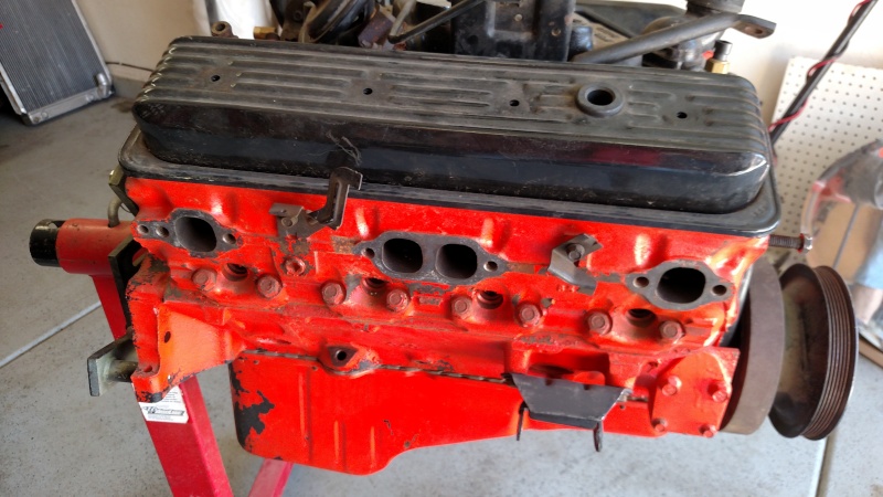

Pulled the motor to freshen it up, decided to coat it with ceramic paint first, and then the colors that I will be going with on the body eventually. Once it goes back in, I want it to stay in!!!
I stripped all the previous paint off first then primed and painted, about four to five total coats...not to shabby if I do say so myself
